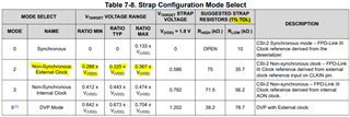

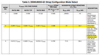

We are planning to use Non Sync Mode. Therefore, an external oscillator was added.
10k and 4.7k were adopted as Strap Configuration Mode resistance, and 5% resistance will be used.
I added a table below that calculates the mode pin input voltage using 10k and 4.7k.
Max 0.615
Typ 0.576
min 0.537
And, I didn't add ferrite beads to the poc line, should I?

    2) For the MODE pin, the selected strap-resistors are fine. You just need to create a voltage divider that outputs a voltage within the voltage range of the mode that is desired. We normally suggest 1% tolerance resistors for a tighter range, but it is not required. Your 10k-Ohm pull-up resistor and 4.7k-Ohm pull-down resistor with 5% tolerance do match the voltage range for Non-Synchronous External Clock mode, highlighted below.
