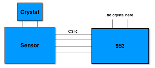

    2.  Clock mode
    For below use case, non-sync, 953 have no crystal while sensor have crystal, does this setup work or not?
  • Hello Huang,
    The 953 has a maximum supported MIPI rate of 832Mbps/lane and can not accept any higher rate under any condition. It can not work with 932 or 1.5Gbps/lane.
    #2 can work if the 953 is used in sychronous mode with a compatible deserializer. There is no need for synchronization between the sensor clock domain and the serializer clock domain
