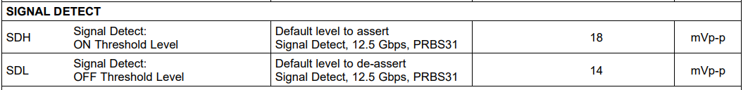

Hello, based on the DS1125DF111 transceiver data transmission module, in the case of a direct connection with a cable, the receiving end can detect and lock the signal, but with wireless transmission, the receiving end can only detect the signal, not lock the signal,What has gone through from detecting the signal to locking the signal, and from the signal integrity analysis, what factors cause the signal to fail to be locked?At present, the interface is 1.25G ,I have choose MODE 0,and register 0x3A= 0xFF.and the register 0x02[3]=0.
  • Hi Kevin,
    Looking at the datasheet, it appears that the signal detect is pretty sensitive to a signal (see below).  I'm not sure what the exact figures are for 1.25Gbps, but I imagine that the signal detect system still remains sensitive at that frequency.
    A couple things come to mind that may be worth investigating.  When configuring the data rate, do you assert and release the CDR reset (register 0x02[3:2])?  Also, something that affects CDR lock in addition to signal amplitude is the jitter.  Is it possible that the wireless transmission system has more jitter than the direction connection?  If so, have you considered using adapt mode 2 or 3 on the retimer?  These modes enable DFE adaption in order to help compensate for jitter.
