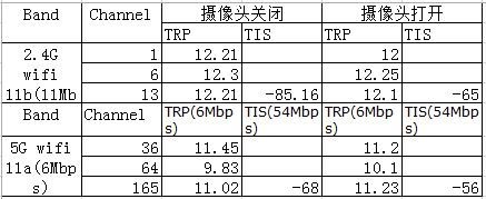

The reception sensitivity of Wi-Fi 2.4G and 5G deteriorated significantly when the camera function was turned on.The data are as follows:

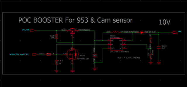

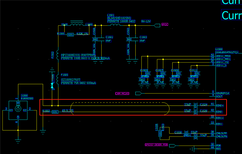

The camera and WIFI module are powered independently. The boost circuit of DS90UB953-Q1 is as follows,

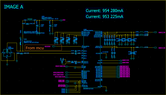

Part of the design circuit of DS90UB954-Q1 is as follows,
We suspect that this problem is caused by MIPI interference during signal transmission, so we consider adding filters on the line RIN0 to reduce noise interference. Whether the idea is feasible? Or can u give us some better suggestion?

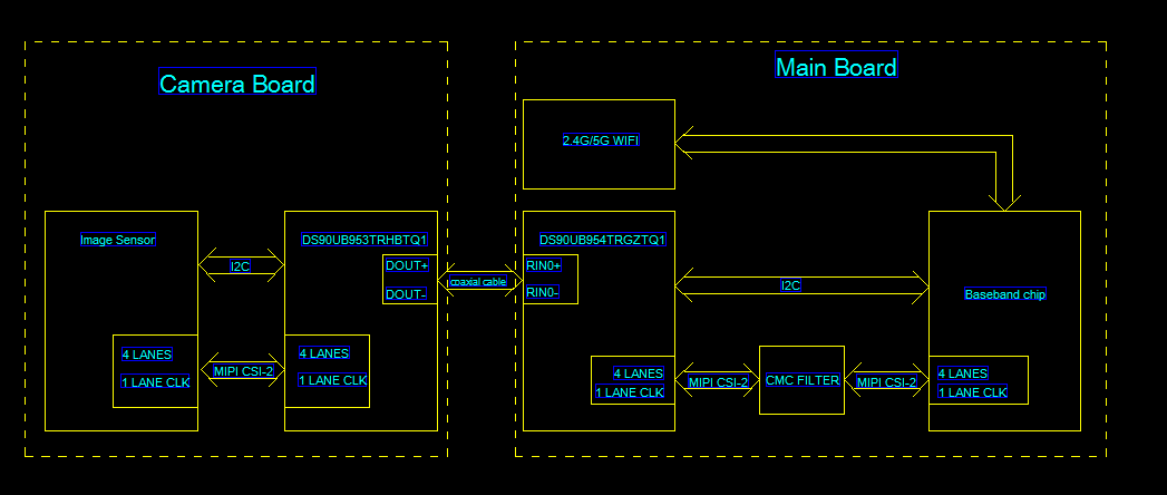

    2) I am not sure if I understood your topology! Can you skitch a block diagram? Where is the WiFi used?

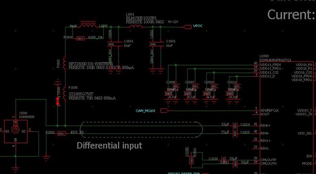

    3) You said, you think the problem is coming from the MIPI interface, but which interface do you mean? SER input or DES output?
    4) If you are using Differential Input at the 954, then yes, you can use a CMC their which we recommend also in case of EMC issues.

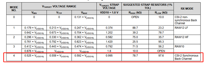

    1,Mode=4(CSI-2 Synchronous Back Channel),CLK=24MHz
    We using single-ended 50-Ω coaxial cable for SER/DES communicate
    As shown in figure 45 .
    2,Block diagram
    3,We think the problem is coming from the “RIN0+,RIN0-“

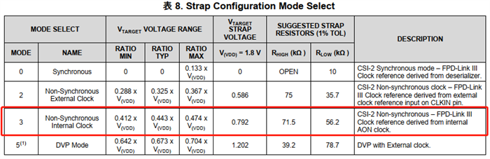

    - Try using non-synchronous AON clock mode with the 953 instead of synchronous mode (strap 953 for AON clock mode and set the 954 back channel to 10Mbps instead of 50Mbps)

    2,Try using non-synchronous AON clock mode with the 953 instead of synchronous mode (strap 953 for AON clock mode and set the 954 back channel to 10Mbps instead of 50Mbps)
    Strap the 953 to non-synchronous AON clock mode with the MODE pin or use 953 register 0x03 to set the mode. On the 954 use register 0x58 to change the BC speed to 10Mbps

    1,We made the following modifications for Mode Pin of DS90UB953-Q1
    2,We made the following modifications for Mode Pin of DS90UB954-Q1

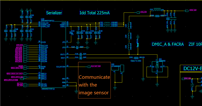

    The logs indicate that after the switchover the 954 and 953 are locked so not exactly sure what the issue is here. Is the sensor itself not responding to I2C commands? Can you send the schematic for the sensor board? One difference I can think is that in AON clock mode the 953 does not output a CLKOUT to the sensor link it does in synchronous mode. Maybe the sensor is expecting an output clock from the 953?
    Casey
  • Hello Casey
    The following is the schematic diagram of the 954 and 953 sensors,Thank you!
    1,DS90UB953TRHBTQ1
    2,DS90UB954TRGZTQ1
  • Hello Jimmy,
    It looks like this sensor does have a connection for CLKOUT. In AON clock mode there is no CLKOUT to the sensor - can you confirm if this would cause a problem in your system?
    Casey
