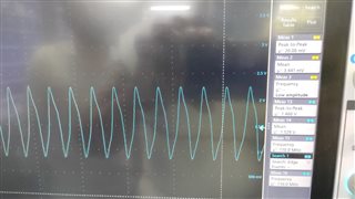

  • Hi Drew,
    we have attached some scope result of RXCLK.
    (1)  when data was not getting changed at tx that time RXCLK result.
    (2)  when data was put on TX including comma characters, by that time received clock.
    Krunal
  • Hi Krunal,
    Thanks for your patience.  I was out of office last week due to the holidays.
    If you still have concerns about the GTX clock noise on the power supply, would it be possible for you to share your PCB layout?
    Thanks for getting captures of RXCLK.  The 2nd capture when data is sent on TX looks really strange.  Was this scope capture taken in a loopback configuration?  If so, was it internal or external loopback?
    How does RXCLK look when using the build in PRBS generator?
    Drew
  • Hi Drew,
    Now , GTX clock working fine and we getting pure power supply.
    Yes, it was on internal loopback.
    That time makes proper RXCLK .
    Krunal
  • Hi Krunal,
    Thanks for the clarification.
    Your RXCLK seems really strange.  It seems that there is some sort of correlation with the data you are sending and the RXCLK signal.  Is RXCLK good if you send PRBS data through an external loopback?
    I am wondering if for some reason that clock is not tracking the data signal correctly.  If you toggle LCKREFN low, the RXCLK should lock to TXCLK.  Can you confirm that the RXCLK clock signal is good when this is the case?  After this, set LCKREFN high and see what happens to RXCLK.  If possible, maybe trigger your scope on the rising edge of LCKREFN while probing RXCLK.
    Here is another thing to test:
    If you just send repeated K28.5 comma and no other data, how does RXCLK look?  Please include a scope capture if applicable.
    Drew
