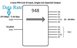

    948 supports 1 or 2 lane FPD-LINK III input and dual link OpenLDI output, if we only use one lane RIN0+/-, does 948 can output dual link OpenLDI in the same time?

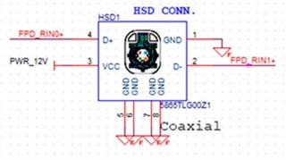

    2. If 941+948 supports 2 lane FPD-LINK III input, did you recommend use the same coaxial? and can we use the same HSD connector?
    Please refer the figures as below.
    3. base on our design, did you have a guide line to teach us how to calculate the HSD data rate??
    Any recommendations please let me know.
    Thanks a lot.
  • Hi Statham,
    I will take a look again at your schematic, and get back to you mid-late next week.
    As for your other questions:
    1. Regarding the two panel specs you sent me, I could only find LCD timing for 1280x800 and 960x1080, not 1920x1080. As for the configuration of the 948, the device can be configured in following modes:
      • 1-lane FPD-Link III input, single-link OpenLDI output
      • 1-lane FPD-Link III Input, Dual Link OpenLDI output
      • 2-lane FPD-Link III Input, dual-link OpenLDI output
      • 2-lane FPD-Link III Input, single-link OpenLDI output
      • 2-lane FPD-Link III Input, single-link OpenLDI output (replicate)
    2. Yes, you can use the same cable/connector. See our EVM for an example.
    3. The FPD line rate is PCLK*35
    Let me know if you have any additional questions.
