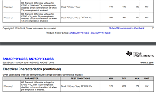

    Register 0x0E bit [5:4] controls the HS TX voltage TX SWING level
    00 – 180mV
    01 – 200mV
    1X – 220mV
    Bit[1:0] controls the HS TX Pre-emphasis
    00 – 1.5dB
    01 – 0dB
    1X – 2.5dB
    The failed test is AC Common-Mode Signal Level Variations between 50 and 450 MHz which can't be controlled by the DPHY440.

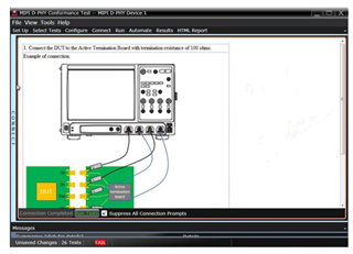

    What equipment did they use for testing? Do they have the termination board setup for the MIPI compliance testing?
    David

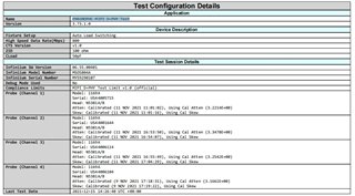

  • Hello David:
    Our test equipment is " Keysight MSOS804A Mixed signal Oscilloscope"(8 GHZ  20GSa/s 10-bit ADC
    Conformance test app: D9020DPHC MIPI D-PHY Testversion3.73.1.0
    CTS version:V1.0
    Do they also have the active termination board connected as shown below?
    David

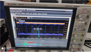

  • hello David:
    My client didn't sample test board. We tested it from flying wire (short enamelled wire) at test point
    Other projects of my client are also tested in this way.

    My client follows the connection instructions on the mipi protocol of the oscilloscope to connect the probe and the signal。
    channel 1: TDP0
    channel 3: TDN0
    channel 2
    CLKP
    channel 4
    CLKN
    Regarding the mipi DPHY test fixture you mentioned, we don
    t have it. My client uses a short enameled wire to solder directly to the test point (as shown in the picture in the previous email). previous projects are also tested in this way.
    There is also an request on 12/20. I hope you can reply and give some advice. Thanks!!!
    For MIPI, they need to switch between the open/100-ohm receiver termination for the LP and HS mode. How are they able to achieve this with the current measurement method?
    For the question sent on 12/20, they need to make sure their test setup is correct, otherwise the results are not valid.

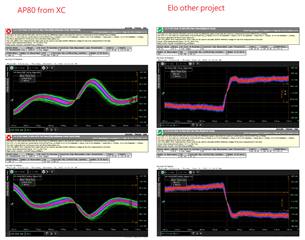

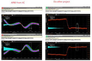

  • Hi David:
    The following figure shows the comparison between the measurement fail project provided by XC(using DPHY440) on the left and other EA pass projects of our company on the right. The wave pattern of XC is obviously deformed Pls check it, Thanks
    Your issue is being reviewed by the appropriate engineer. Due to the US Holiday there may be a delay in response to your post. We apologize for any inconvenience.
    Is the other project also using the DPHY440?
    The reason I was asking for the test setup is because the output clock amplitude does not match what is expected from the DPHY440 as shown below.
    David
