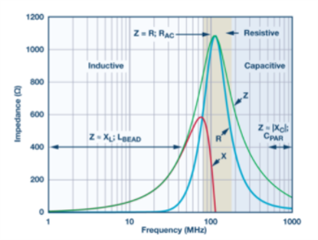

    Do we know the electrical characteristics of the ferrite beads used? Like a curve as such:

    The used ferrite beads are 742792040.
    742792040-1720361.pdf
    When they were installed near the device, they were no effect.

    Looks like the ferrite bead is attenuating the correct range of frequencies as per the datasheet. The 80MHz - 100MHz range seems to be in the resistive region of the ferrite bead as per the datasheet.
    I figure that connecting near the middle of the transmission probably helped to reduce the antennae affects that I described previously. I think it is a good idea to implement the ferrite beads at the middle point. The capacitance on the other hand is tricky. TCA9803 follows I2C standards for bus capacitance which is standardized at <400pF. If you plan on adding more capacitance, keep in mind trace capacitance from the PCB, # of devices connected to the bus, signal rate, pullup resistance value, etc. An I2C buffer solution might be helpful in resetting bus capacitance if the design is nearing the 400pF limit.

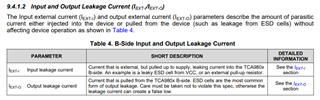

    I forgot what device we looking at in this question. This is my bad. The TCA9803 is a I2C buffer. This device separates the bus capacitance from one side of the bus to the other. So theoretically, you could have double the amount of capacitance: 400pF on A side, 400pF on B side. This fact gives more design room concerning capacitance limitations due to I2C standards.
    In the schematic for the slave/target side, I see that there are pullup resistors R7, and R6. I see that they are open, but these resistors should not be present on the B side even when the TCA9803 is not active:
    It is recommended to leave the pins on the B-side floating if unused as per the datasheet:
    External pull-ups could potentially provide additional current pushing the IILC out of spec, preventing the bus from being able to transmit a logic LOW.
