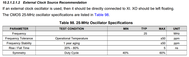

  • Hi Sreenivasa,
      Thanks for the additional info.  I realized I had not answered your question on the source of register configuration.  We started with Xilinx driver for DP83867, then modified to include steps from the DP83867 troubleshooting guide from TI, then added additional debugging instrumentation.  We have also tried using the LOOPCR instead of BMCR for other loopbacks, but decided to focus on MII loopback which is programmed through BMCR, not LOOPCR.
      So we did have a breakthrough over the weekend.  We have discovered removing the crystal and replacing with function generator, then the board passes the MII loopback test at 1G.  Following the DP93969HM datasheet, we have tried 36pF capacitors for CL1 and CL2, which is 2x the load capacitance of the ABM3 internal load capacitance of 18pF.  We have also tried 18pF.  It oscillates as expected at 25Mhz for both, but just seems to shift up to 27Mhz for couple clock cycles when we attempt to transmit data.   Any suggestion on what we should do different?  We are not currently using R1.  Would it make a difference in this case?

    Regarding the crystal, i do not need the exact part number. Please note that if the crystal in a 4 pin type, some times customers tend to route the signal inside the crystal and it is recommended to avoid this.

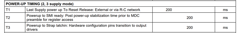

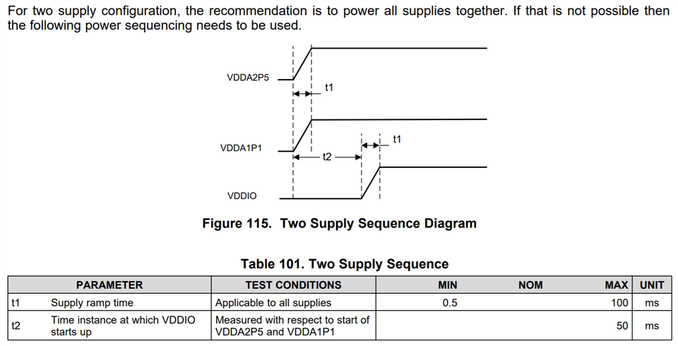

    The 4 PHYs have 4 crystals and are all the 4 PHY layouts somewhat identical.  Are all the PHYs showing similar behaviour ?
    How is the reset controlled for all the devices ? Could you please check if the below timing is being followed.
    Could you also check if the power supply meets the below requirements
    Sreenivasa

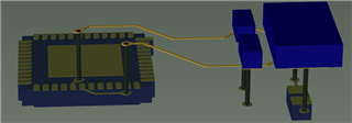

  • Our board layout using the 869 is as follows, similar layout using 867 works.  The only difference in the layouts are XI/XO pin (14/15 vs 19/20)  locations.  On 867, the trace lengths are ~75 mils shorter.
    The schematic is as follows.  It works using 867.  It does not work using the 869, we tried capacitors ranging from the 18pF up to 33pF.  We have also removed the 1Mohm resistor. We have also tried a different crystal and have tested on multiple PHYs.
    We did configure the CLK_OUT and look at the output.  When configured to output 25Mhz, we don’t see the shift.  However, when CLK_OUT is configured to output 125Mhz, we do see the shift in frequency when data is being transmitted (MII loopback).
    Again, our decoupling caps are not in the best location on this layout.  However, on one of the PHYs, we have dead bugged additional caps very close to the pins.  When we replace the crystal with a function generator, the PHYs work with or without the additional caps.   When using the crystal,  we have about 40% error messages.  An error message has the frequency shift, good messages do not have the frequency shift.
    Thanks for your help and supporting us as we seek root cause,
    Ron

      In answer to your previous question, both the power up timing and the reset  meet the datasheet requirements.  All four PHYs show similar behavior.  Some are worst than others.

    Thank for the layout.
    I see a number of vias close to the crystal routing. Are these all ground vias ?
    Also where are the load caps connected ? Did you trying putting a series resistor on the Xi and Xo  pins ?
    Sreenivasa
  • Hello Sreenivasa,
    The crystal and 1M ohm resistor are on pads at bottom.  Just above are the four pads for the two capacitors (CL1 and CL2 in figure 110 of datasheet). The 6 pads above those are  decoupling caps for the 1.1V.  One side would connect to the ground plane, the other side to 1.1V plane.  Above those is R575, which connects between ground and pin 12 (RBIAS) on PHY.  Above R575 is R13 which is pullup to 1.8v for MDIO(pin 41 on PHY).  Near top of traces to right are three vias under the PHY (U4 on layout) which are connected to ground.  The via under the start of the “U” on U4 connects to pin 9 on PHY, going to 2.5V plane.
    Does this answer your questions?  I need to check with the team if a series resistor was added (and value used) as a step in our troubleshooting steps. Currently it is not there. What value would you recommend for the series resistor?

    The crystal is on the bottom side and the 1M is on the top side connected to the crystal trough vias on the crystal pads.
    The load caps seem to be after the crystal. Have you tried moving the crystal.
    Can you make use of these two resistor  pads to solder the crystal and test.
    I would add a 47R series resistor to test.
    Sreenivasa
  • Hi Sreenivasa,
      Thanks for the response.   The crystal and caps are on the top side.  The PHY and 1M ohm resistor are on bottom.  See following 3-D diagram:
    I am not sure what you mean by "moving the crystal".  Putting it where the 1M resistor was located moves the crystal farther from the PHY.  I don't believe having the crystal between PHY and caps would make a difference from my understanding of electronics.  Am I missing something?

  • Hello Ron,
    Thank you for the picture. I see a typo in my pervious message.
    The load caps seem to be after the crystal. Have you tried moving the load caps nearer to the crystal.
    Can you make use of these 1M resistor  pads to solder the load caps and do a quick test.
    Sreenivasa
  • Hi Sreenivasa,
      With a function generator providing 25Mhz clock into XI, the PHY passes both MII loopback and can send and receive UDP packets.  We added a white wire to the board and reprogrammed a FPGA to allow an output from the FPGA provide the 25Mhz clock to XI.  We have discovered this allows the MII loopback to pass, however it will not auto-negotiate to allow UDP packets to be sent.  In this configuration, power is applied before the 25MHz clock is available.  We have tried doing a hardware reset after the 25Mhz clock was up, but the PHY still will not auto-negotiate.  Any suggestions?
    Ron

    Did you have a chance to move the load caps near to the crystal ( using the 1M pads) and perform some tests.

      We measured and confirmed the XI input met the specifications in the table above last Friday.  We made a discovery yesterday, on voltage level.  Turns out while we programed the FPGA for 1.8 volts out, it is outputting 2.5v which exceeds the max high level voltage for IX input.  We are working to correct.  Could this cause the loopback to pass, but auto negotiation to fail?
      We still don't understand why using the crystal per our original design fails.  Following the crystal manufacture's suggestion, we placed a POT in series on crystal input. This led to that PHY no longer passing loopback testing, but still see activity on LED.  We still have 3 other PHYs on that board, one connected to function generator, one connected to FPGA and one still in our original design configuration with a crystal.

    Sorry to ask you again, Did you have a chance to move the load caps near to the crystal ( using the 1M pads) and perform some tests.

    Was the crystal closer to the device in the DP83867 board or was this similar to what we see in the DP83869 based board.

    Thank you for the inputs. Did the location of the PHY change with the boards.
    Is the capacitor after the crystal nearer to the PHY for the DP83867 board also?
    Sreenivasa
  • Hi Sreenvasa,
      I confirmed with our board layout guy.  It is the same between the 867 and 869 boards.  His words:  location of the PHY, Crystal, caps and resistor shown in the 3D model I gave you are identical between boards.
      Only difference is where the traces touch the PHY, they are longer on 869 due to pin locations moving.

  • Hello Ron,

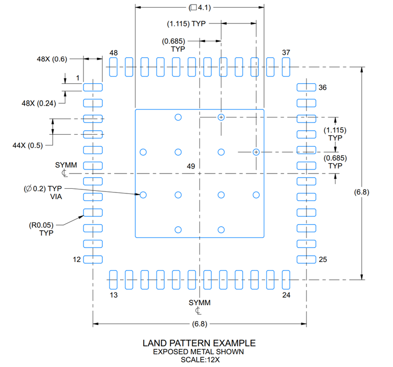

    Thank you. In the 3D i am seeing a rectangle picture as against square as shown in the picture attached. Any thoughts.
    Sreenivasa
  • Hi Sreenivasa,
      Are you referring to the ground pad (pin 49) under the PHY?  The 4.1 square on the Land Pattern Example you provided above?
    Ron
