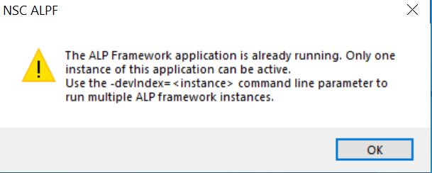

Hi Expert,
when I run ALP, below dialog comes out. Could you please explain why and how to address it?

Hello Elec,
If ALP crashes during operation, sometimes it can leave a process still running which prevents it from starting again. If this happens go to task manager and manually end a process called "MainGUI.exe"
