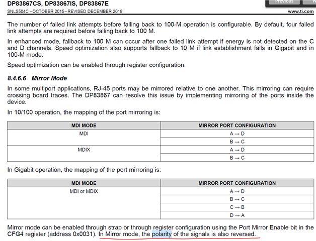

DP83867E: MDIX and cross wire in pare singal
Part Number: DP83867E
According to the datasheet section quoted in below. have some questions:
When mirror signals between PHY and RJ45,  must swap */- signal pare? or optional to swap? if it is optional, can swap only partial signal pare? Is it automatically detected? or need register configuration to enable WIRE Cross?
