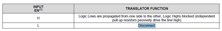

Hi Team,
We have below questions for PCA9306. Could you please help to provide your comments? Thanks.
1. What is the "Disconnect" meaning when EN = Low?

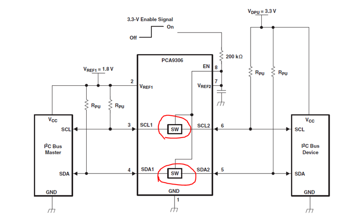

2. When EN= Low, will SCL and SDA pin have leakage to each other?

See [FAQ] How do the LSF translators work?
The switches are simply N-channel MOSFETs. When EN is low, the gate-to-source voltage is zero or negative, and the transistor is inactive.
The leakage current is specified as IIH ≤ 5 µA.
Hi Clemens,
Thanks for your reply.
Does IIH mean device quiescent current or the leakage current of SDA/SCL SW?
Hardy
