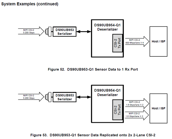

    How are you getting 1.24Gbps (for 3840x2160@60fps, RAW10, 4 lanes)?
    In the deserializer you have 4 data lanes. If you are getting 1. 2Gbps from the imager, on the deserializer you can have 2 lanes each at 800Mbps.
    System examples:
     (click to enlarge)
    Yes, if you choose 800Mbps as your CSI-2 lane rate, skew calibration will be enabled. According to the MIPI D-PHY specs, you need to have the skew calibration enabled for speeds greater than 1.5Gbps; that's why it's instructed for 1.6 Gbps CSI speed to do so.
