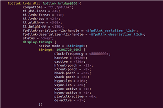

Dear TI team,
Thanks for providing the quick support for the previous query.
URL: https://e2e.ti.com/support/interface-group/interface/f/interface-forum/1038168/ds90ub941as-q1-issue-in-configuring-and-verifying-pattern-generation-ds90ub941as-q1------ds90ub948-q1?ReplyFilter=Answers&ReplySortBy=Answers&ReplySortOrder=Descending

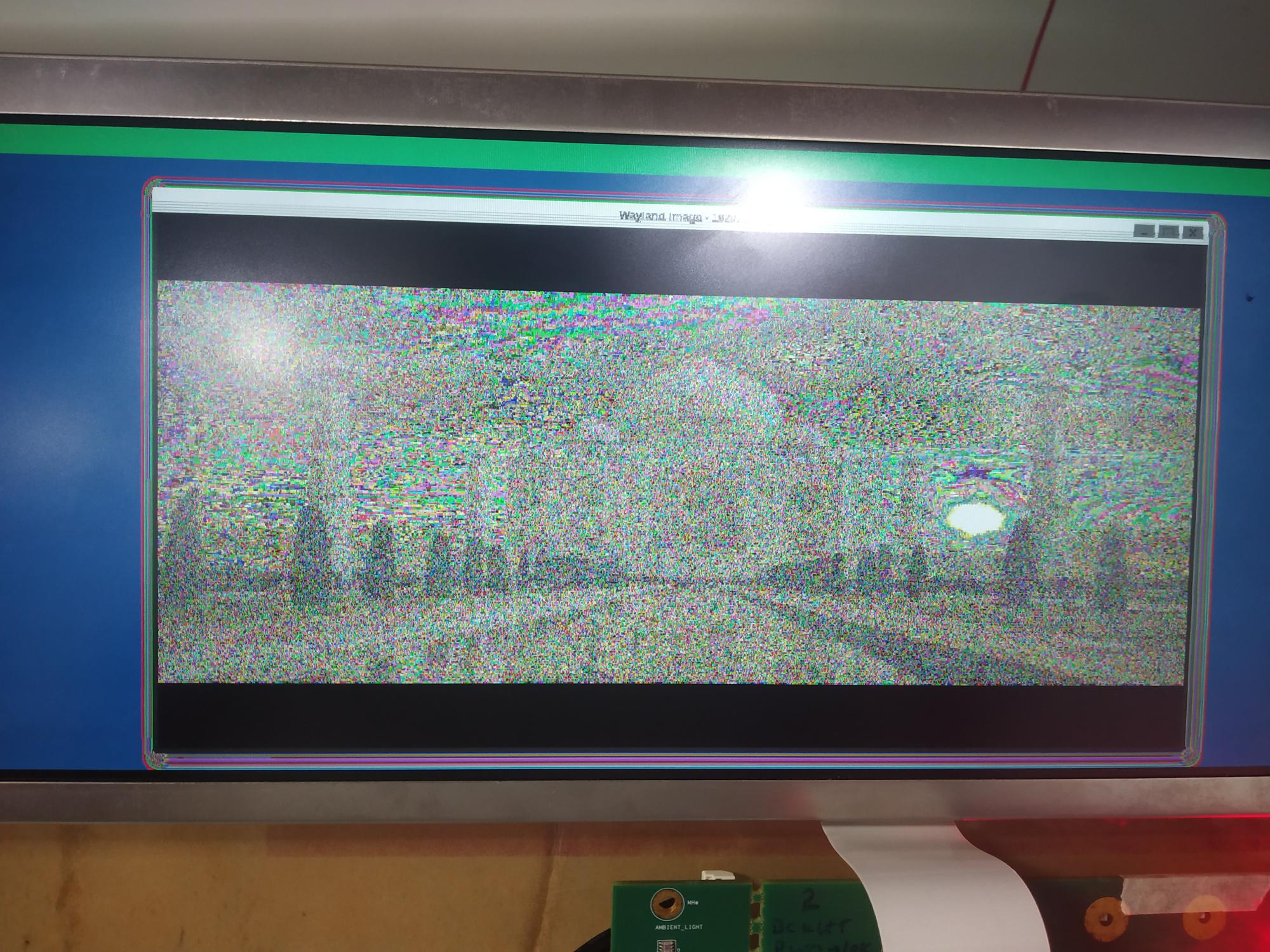

Continuing to the above ticket, we are trying to display some pictures (.png, ,jpg etc) onto the LVDS Display using weston library and tried the same with drm-frambuffer application.
Reference link :  https://embear.ch/blog/drm-framebuffer
But the image quality is not good.
Attaching the register dump for the serializer (DS90UB941AS-Q1)and De-serializer(DS90UB948-Q1)
Register dump with weston enabled:

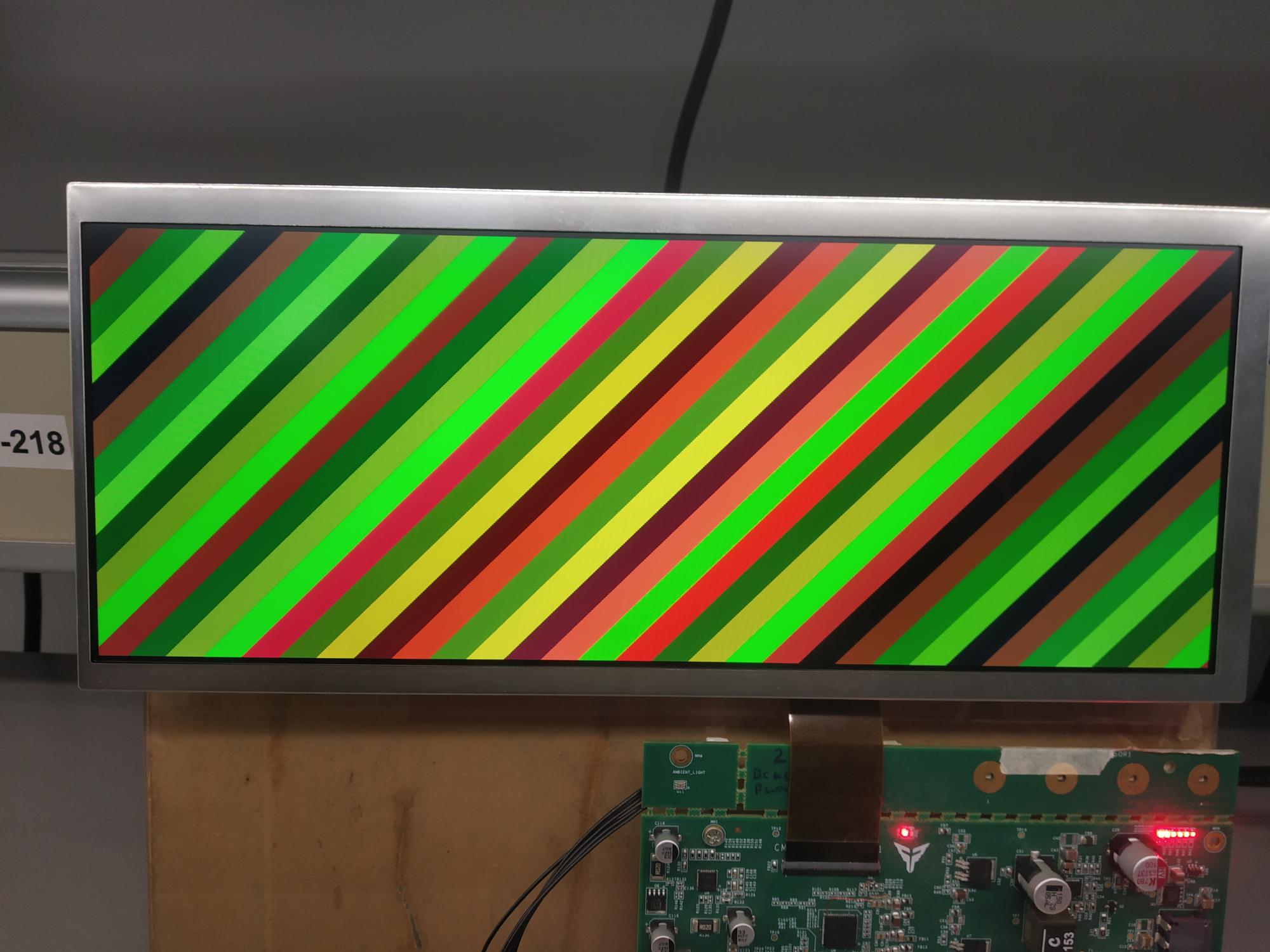

root@dictgu:~# modetest -M imx-drm -s 148@38:1920x720-59.86 -Ftiles
setting mode 1920x720-59.86Hz on connectors 148, crtc 38
failed to set gamma: Function not implemented

*********Display connector and encoder details*****************
root@dictgu:~#
root@dictgu:~#
Encoders:
id      crtc    type    possible crtcs  possible clones
147     38      DSI     0x00000001      0x00000001
149     96      DSI     0x00000004      0x00000002
Connectors:
id      encoder status          name            size (mm)       modes   encoders
148     147     connected       DSI-1           508x190         1       147
  modes:
        index name refresh (Hz) hdisp hss hse htot vdisp vss vse vtot)
  #0 1920x720 59.86 1920 1952 1968 2000 720 728 730 735 88000 flags: ; type: preferred, driver
  props:

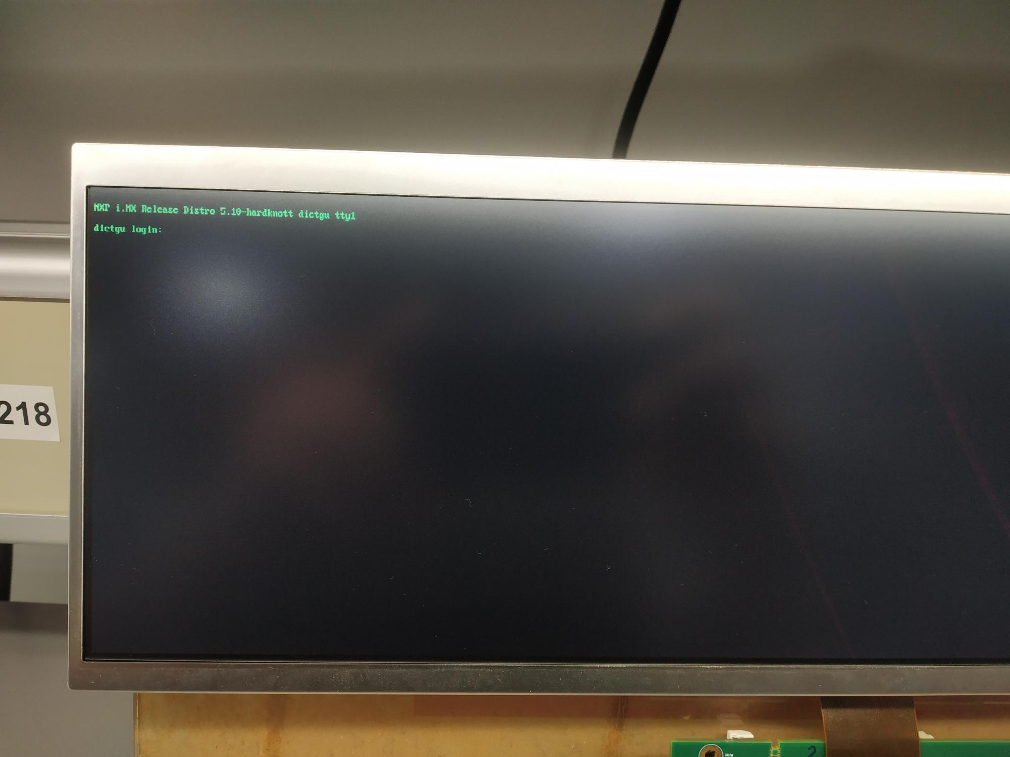

And target board console and modetest patterens are perfect. Attaching the reference images
While trying with weston library to render an image onto the Display through DRM framework where the TI FPDlink-III bridge drivers will come into picture.
Reference for the bridge drivers is https://lists.freedesktop.org/archives/dri-devel/2019-March/210542.html
Attaching the original and processed image for your reference.
Is there any any registers (related to DSI clock) need to be updated at serializer or De-serializer?
Please help us to get the image quality.

    Attaching the Display Timing parameters for your reference

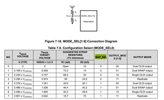

    Right now, MAP_SEL is 0 and the config is as follows
    R1 = OPEN and R2 = 10K
    Is it required to have R1 = 49.9K and R2 = 30.1K to get MAP_SEL to be 1?
    As per the link: https://e2e.ti.com/support/interface-group/interface/f/interface-forum/893900/ds90ub941as-q1-lcd-does-not-display
    They were facing the similar issue as we are. Some how they were able to solve the issue with MAP_SEL to HIGH. Will this help in our case also?
    Can you provide some brief on this MAP_SEL (effect of the display content)?
    Thanks and Regards
    Saikrishna
  • Hi Logan, Our issue is resolved when we change MAP_SEL to HIGH(R1 = 49.9K and R2 = 30.1K).
    Thanks a lot for your support on this debugging.
    Can you provide some brief on this MAP_SEL (effect on the display content)? We have not found anything related to MAP_SEL in the datasheet.
    Thanks and regards,
    SAIKRISHNA
  • Hi Saikrishna,
    Glad to hear it is working.
    MAPSEL controls the bit mapping of the OLDI interface on 948.
    Logan

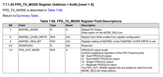

    This MAP_SEL is configured from Hardware side as of now. Is it possible to configure from software?
    MODE_SEL register is Read Only registers. So, we are unable to write this register
    Is there any software register through which we can handle this(MAP_SEL configuration) from software side?
    Thanks and Regards
    SAIKRISHNA
  • HI Saikrishna,
    Please refer to below register:
    Logan
