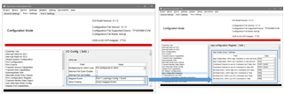

TPS65988: How to clear Dead Battery Flag(4CC command DBfg) by using Load App Config of GPIO event and App Configuration Resister.
Part Number: TPS65988
Could you tell me How to clear Dead Battery Flag(4CC command DBfg) by using Load App Config of GPIO event and App Configuration Resister ?
I tried to set Load App Config of GPIO event and App Configuration Resister by Firmware tool.
Is my setting OK?
