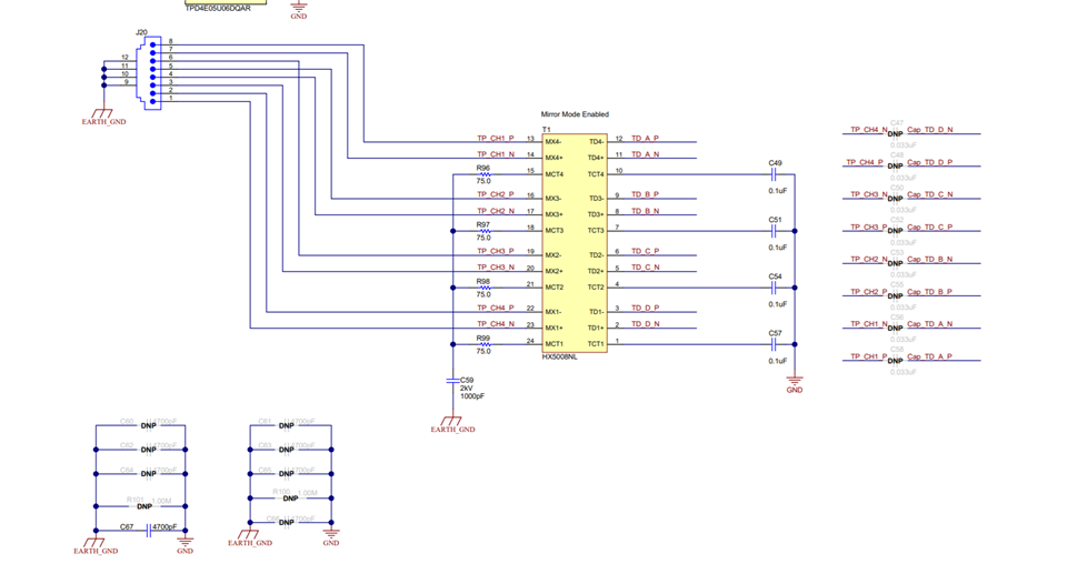

I'm using DP83869HMRGZT PHY in SGMII to Copper mode (1G).
Kindly review the attached schematic. And suggest if any changes to be made.DP83869HMRGZT_SGMII.pdf

Hello Ranjini
Thank you. s there a shield for the connector and is the shield connected to a separate ground.
If possible please share the schematics of the MDI interface.

Hello Ranjini,
Please refer below use case for the connector diagram.
There is an C + R in parallel connected between shield and the circuit ground.
The Cable side of the magnetics is referenced to shield and the PHY side to the circuit ground.
In the schematics you provided, i see both sides of the magnetics on the same ground reference.
Sreenivasa

Hello Ranjini,
Regarding the isolation between circuit ground and shield please follow the above message. You can refer to the DP83869 EVM for details.
Sreenivasa

Hello Ranjini,
Received the note below on the updates.
I've changed the ground reference after magnetic to Earth_GND.
The cable shield will also be connected to Earth_GND.
The AC caps have been placed.
These changes look good.
Please be sure to take care of the power supply ramp time and sequencing.
Sreenivasa
