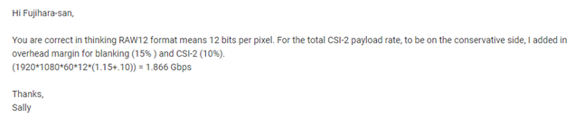

I watched the CSI bandwith calculation video below and need your help clarifying incorporation of overhead into the calculation so I can understand the limits of our seralizers better.
Video: https://training.ti.com/csi-2-aggregation-breakdown?context=1134310-1139225-1148220
The input bandwidth section has the following calculations:
I have an example that is very close to the 3.328Gbps BW limit of the 953 so I need help understanding if I'm calculating everything right. Here is my calc sheet:
Using a 4.16Gbps Link and a 953 with bandwidth capabilities of 3.328Gbps it looks like this will not work unless I dial the FPS down to 58 fps instead of 60.
Am I understanding this correctly?
My main question is do I still need to add an additional 10%-25% overhead on top of this like we do with the FPD calculator or does this somehow get accounted for in the calculation?
- If I do still need to add an additional overhead is just using 10% (or maybe less) for the CSI overhead enough as I've already accounted for blanking in the above calculation?
