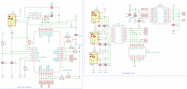

Part Number: TUSB2046B
I attached the schematic of the USB Hub. Keeping get power surge warning when connect to computer.
I checked many schematic and datasheet, not sure what caused the problem.
RN3 is 4816-T01-153LF, 15k resistor networks.
 So far I tried fly wire from EN4 to PWRON4 and OC4 t OVRCUR4. Not helped.
  • Do you have pullups installed on the OVERCUR/ inputs to the hub?  It sounds like an overcurrent event is getting flagged.
    JMMN
  • I installed pull-up for all 4 OVERCUR Pins, now this what I see:
    1. without any load, I still have power surge warning.
    2. with load(keyboard), no power surge warning, but system still not recognize my device.
    question: should I do anything for PWRON4 pin, its no connect now.
  • Hi Thomas,
    PWRON4 should not impact the power surge.  How much capacitance does your design have on +5V?  It looks like there could be a in-rush current issue.
    JMMN
  • Hello JMMN,
    I have 100uF for each usb port.

    I think the computer can communicate to usb hub, but the usb ic not ok with the power, or some other thing I missed.
    I will upload the latest schematic.

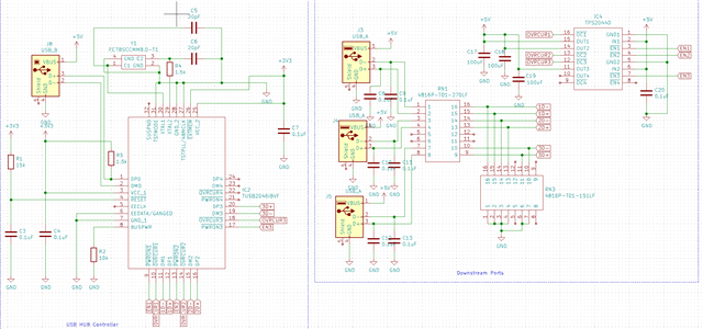

  • the latest schematic
  • Can you check if the crystal starts?
    Can you check what occurs on the DP/DM lines between the host and the hub?
    JMMN
  • Hello JMMN,
    The issue was I did not separate the 5V for each usb port. causing there have 4 modes of the UBS hub ic, I selected the individual self-power mode, but I did not individually that downstream 5V. Now I need to collect those.
    Thank you
  • Ok, have you been able to confirm that the design works with an external power supply?
