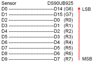

  • Hi Richard,
    The 940 can output RAW10 when receiving RGB input. In the 940, when configuring to output RAW10, it will only pick out the 10 bits that are necessary from the Serialize, Please see the below diagram for the proper data formatting of 24 bit RGB (RGB 888) to RAW10. Can you check that the 947 is passing the correct 10 bits to the 940? Note the diagram says 925 but the bit alignment is the same.
