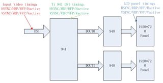

1 . 941-> 2 Des 948 -> 2 1920*720 panel, as folllow

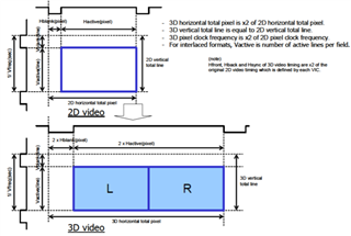

    If it is working in PatGen mode, then this is either a Superframe set-up issue or input video issue.
    I've reviewed the script and register dump, and there appears there could be issues with the set-up script.
    In the script, both DSI port 0 and port 1 is configured. Can you share the full DSI system details of your application, so I can make sure the code is properly configured? Lane count, port count, DSI clock mode, etc?

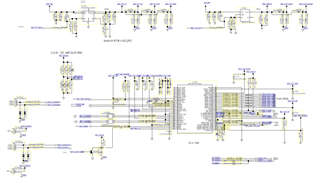

    Can you also provide schematic, so I can take a look at the strap settings?

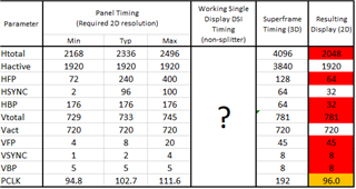

    Below is an example symmetric split example.
    # 3840x720@60 Symmetric Split Example - 2x 1920x720@60
    # Video 0 and Video 1 Parameters:
    # HACT = 1920
    # HFP = 64
    # HSYNC = 32
    # HBP = 32
    # VACT = 720
    # VFP = 45
    # VSYNC = 8
    # VBP = 8
    # PCLK = 96MHz
    # DSI Superframe Dimensions:
    # HACT = 3840
    # HFP = 128
    # HSYNC = 64
    # HBP = 64
    # VACT = 720
    # VFP = 45
    # VSYNC = 8
    # VBP = 8
    # PCLK = 192MHz
    # DSI clock = 576MHz
    # DSI Lane Speed = 1152Mbps/lane
    # 4 Lanes DSI

  • Hi Logan,
    add schematic and full serdes init code,please help to check,thanks.

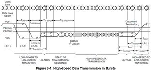

    Does the dsi clock affect 941 splitter ?
    use single lcd dsi video signal ,pclk = 101m , dsi clk = 303m, splitter mode pg can work.
    but use superframe dsi video signal pclk = 203m , dsi clk = 609m, splitter mode pg can not work.

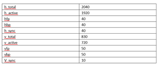

    lcd panel timing:
  • Hi Jianlin,
    Can you please comment on the above DSI parameters? Correct script configuration depends on the DSI source and configuration, so I would first like to ensure the device is getting put in the proper mode, and the other DSI timings in the script such as TSKIP count, etc are being properly configured ( and strapped via modeSel pins). Based on schematic, it looks like only one DSI ports is being used, and 4 lanes; is this correct?

  • Hi Logan,
    Thanks for your reply.
    Today i use RevB_941AS_SuperFrame_Calc.xlsm to config 3840*720 splitter mode setting.
    I try dsi clock 620m & 660m, generate 941's setting, and input 620m/660m dsi to 941,only the TSKIP CNT value is different for different dsi clock,
    but still can not display. I find the dsi clock will affect splitter mode link.
    I can not find any porch timing setting in the tool.Does the 941's setting need to
    consider the timing of the lcd panel?
    Please help to create a 941 script for our configuration,thanks

    Where is the Hsync=64px coming from? This does not seem to match the display timing attached earlier:
    Wouldn't it be 48*2=96?
    Logan

    Could you explain them? As follow,there are 3 timings, the input video timing,the 941 dsi timing and the lcd panel timing.
    For the timing configuration of 941, how to config?
    Does the 941 just transmit the input dsi timing to the lcd panel?
    Thanks very much.
  • Hi Jianlin,
    Can you elaborate what you mean about the 941 DSI timing in green? Are you referring to particular registers, or are you just referring to how the 941 will crop the superframe and forward to each of the two ports?
    You bring up a good point though, I think some of these DSI timings might need adjusted to properly generate the correct superframe and cropped image sizes for each display.
    I will look further into those, and provide feedback on Monday morning.

  • Hi Logan,
    I mean the dsi indirect registers configuration (0x30-0x33) on the one hand ,and on the other hand how the 941 transmit the dsi video to 948 and the panel,
    how to ensure that the LVDS signal received by the panel meets the timing ?

      Regarding your questions on DSI superframe, 941, and 948 timing. The DSI superframe should be based upon the desired display video timings as described below:
      • Horizontal parameters are all x2 the original 2D values (of single display)
      • Vertical parameters remain the same as original 2D values (of single display)

    1 The Panel timing parameters
    2 DSI superframe timing parameters and clock parameters
    # HACT = 3840
    # HFP = 128
    # HSYNC = 64
    # HBP = 64
    # VACT = 720
    # VFP = 45
    # VSYNC = 8
    # VBP = 8
    # PCLK = 192MHz
    # 4 Lanes DSI
    # DSI input port 0

    I find the 948 is not linked when 941 working in splitter mode, access to 948 also fail.
  • Hi Logan,
    I try to config the 941 timing as follow,
    Splitter mode internal PatGen is successful, dsi clock (580m) mode  is successful.
    Splitter mode dsi clock mode the pannel is black, the 948s link is successful.

    • Did adding the THS_SETTLE and CLK_SETTLE fix the DSI clock errors?
    • Can you clarify which DSI clock frequency is being used during PatGen splitter mode? The TSKIP_CNT value says 300MHz, but you also mention 580MHz DSI CLK.
    • Can you re-attach the register dumps with the lock status update?
    Do you have probe access to the 941 GPIO6, GPIO5, and GPIO4 pins? We can try mapping the timing signals received from DSI packets to output DE, HSYNC, and VSYNC signals and compare they are correct and as expected.
    Logan
  • Hi Logan,
    1 THS_SETTLE and CLK_SETTLE fix the 948s lost link issue, but the dsi errors still exist, the dsi errors exist in  single lcd mode which display successfully.

    941 GPIO5 GPIO6 signal as follow, the yellow is GPIO5,green is GPIO6.
  • Hi Jianlin,
    Can you refer to this guide in order to turn on the debug mode to map to those pins? Sorry, I thought it was originally attached. The below instruction will map pin 14 to DE, pin 38 to VSYNC, and pin 39 to HSYNC. If you are able to get a similar scope show as the previous one attached with all three signals, we can spot check the DSI timing to see if it is correct. Based upon register 0x5F, the per port PCLK frequency is ~97MHz; which seems as expected.
    8171.941AS Sync Signal Extraction for Debug (3).pdf
    I have concerns with the superframe DSI resolution. It seems to violate a few of the min/max parameters of the panel timing you provided.
    • Can you provide the DSI video timing used when doing DSI input - non-splitter mode (single display)?
      • Did you use the panel timing you attached above, or superframe Horizontal values divided by two?
    • Are you able to adjust the DSI superframe's video timing?
    Logan

    1 The input dsi video timing for single lcd and splitter mode as follow.
    # HACT = 1920
    # HFP = 64
    # HSYNC = 32
    # HBP = 32
    # VACT = 720
    # VFP = 45
    # VSYNC = 8
    # VBP = 8
    # PCLK = 96MHz
    # HACT = 3840
    # HFP = 128
    # HSYNC = 64
    # HBP = 64
    # VACT = 720
    # VFP = 45
    # VSYNC = 8
    # VBP = 8
    # PCLK = 192MHz
    # 4 Lanes DSI
    # DSI input port 0
    I adjust the DSI superframe's video timing many times,still can not find the fix timing for splitter mode.
