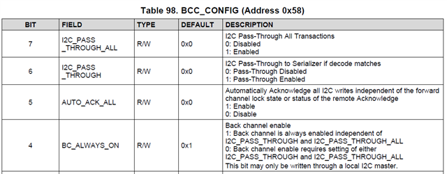

Are you trying to turn off the FPD-Link back channel? Please see register 0x58 and turn BC_ALWAYS_ON to off.
If there is no backchannel then the serializer would need to be in async mode.

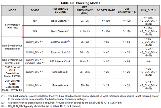

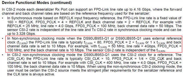

And for the async mode of serializer you mentiond in previous post, do you mean Non-synchronous clocking mode? if the LVDS signal can't be disabled we're thinking about to slow its line rate, thanks.
Hello Chris,
Yes, I meant Non-synchronous clocking mode.
To turn off the forward channel it would need to be done from the SER side - easiest method is to pull PDB = L on the 953.
