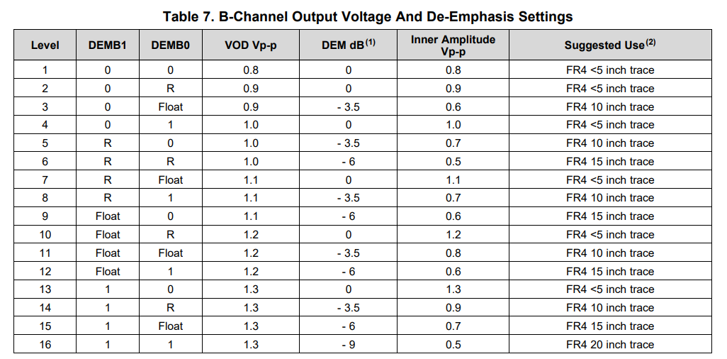

Dear Team,
Attached for DS125DF111 transmitter eye_diagrame and Tjitter measurement using the best of de-emphasis 0x14 (-6dB) VOD setting 0x85 . I first adjusted the VOD setting within spec and then adjusted the de-emphasis. Do you have any comments for de-emphasis adjustment and do we need to add ac coupling caps on SFP+ side?
Board to board connecter s-parameter report refer to the
PCB material - FR4
REV05 SFP test report.pdfSI-BTB-51154_51159-Ac_20200716(PCIe gen 3).pdf
