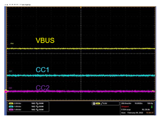

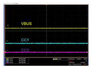

The problem is when type C flipped CC2 no superspeed.
The TPS65988DJ as sink mode.
Please see below waveform to get more detail.

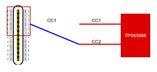

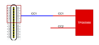

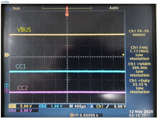

The tester only have CC1, they don't have CC2.- which mean they want to test type C if could be flip or not.
Without flip type C CC1 connect to PD controller CC1. You could see the scope PD controller CC1 is high, CC2 is low, so the PD controller behavior is correct.
With flip type C CC1 should connect to PD controller CC2.You could see the scope PD controller CC1 is high, CC2 is low, so the PD controller behavior is wrong. the CC2 should be High not CC1.
