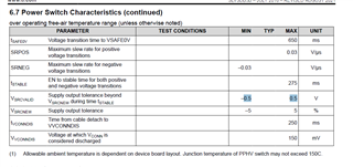

The capacitance is recommended to keep the VBUS clean (removing any noise). If the VBUS receives any jitter outside of the tolerances (typically +/0.5V) it could cause a disconnect/reset within the PD

"If the VBUS receives any jitter outside of the tolerances (typically ± 0.5V) it could cause a disconnect / reset within the PD"

There is information in Table 6.7
This will answer any questions about the frequency of the jitter. There is no issue if it does not fluctuate. The conditions for disconnect/resetting depends on the PD role, the configuration, and the port partner. Either way it should be avoided and you can choose to not use a capacitor there at your own risk
