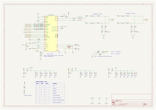

I have developed a board that uses the DP83TG720S-Q1 with the DP83822IRHBR to create a 1000BASE-T to 1000BASE-T1 bridge. So far I've been able to successfully configure the registers and get a link up when using a cable of around 0.5 meters between two of these custom boards.
However I can't seem to achieve a 1000BASE-T1 link with cables over 2 meters.
So I wanted to ask, what kind of maximum distance can we expect on the 1000BASE-T1 side. I do realise there are many variables here, including the CMC, drive swing, connector and the cable, but I just wonder if there is some rough guideline of what the maximum distance we can expect is?
I know the 1000BASE-T1 specification states a max length of 40 meters, but it seems my boards fall well short of that.
Josh

    The IEEE standard, specifies that 15M as the cable reach for normal automotive application, you should get this cable reach, with the 720. We can further extend the cable reach if required.
    To debug your problem, can you please share your schematic, and confirm that you are using the software configuration as in the following document.
    https://www.ti.com/lit/an/snla371a/snla371a.pdf?ts=1645211471774&ref_url=https%253A%252F%252Fwww.ti.com%252Fproduct%252FDP83TG720S-Q1
    I am wondering why you are using the DP83822 as this 100 Mbps, not a GbE.
    Alon

    Thanks for your patience, I have rerun some tests and can now provide you with some more definitive information. Before I do, you should know that I was able to achieve a link with a cable of around 22 meters. So now my question is more "how far can we go? Can we reach 40m?"
    Schematic
    In general the schematic follows the design guidelines. The only exotic thing is that we have SPE connectors, one is a Molex PicoBlade and the other is a Harting T1 connector (Presumably this causes a small stub on the signal)

    I can confirm we are using the configuration detailed in that document, we write to all the same registers as in table 3-1 for the master, and table 3-2 for the slave. I also add another register write to set the RGMII timing, but this should not have any effect on the SPE connection.

  • Hi Josh,
    I spoke with the team, there are many variables at play here, changing one register could have negative effects in an unpredictable place.
    There is no one specific setting the team mentioned to boost cable reach, however they did mention you will likely be able to get further reach using a shielded cable pair as opposed to unshielded.
    Given you mentioned you are running spliced wires, that would be the first item I would replace in order to test and see if you gain cable reach.
    Hope this helped, let me know if you manage to gain more reach.
