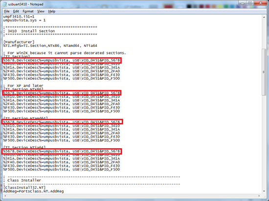

    ·         Hello Oliver,
    Before install the driver the customer will need to modify the .inf file. And add their VID/PID, also they can remove the TI’s VID/PID from the .inf file.
    After running the Installer wrapper file and before run the Installer provided by TI at http://focus.ti.com/docs/toolsw/folders/print/tusbwinvcp.html the .inf file is usually located located at:
    C:\Program Files\Texas Instruments Inc\TUSB3410 Single Driver Installer\DISK1\Windows\tiinst\TUSB3410\Common-64\usbuart3410.inf for 32-bit and
    C:\Program Files\Texas Instruments Inc\TUSB3410 Single Driver Installer\DISK1\Windows\tiinst\TUSB3410\Common-32\usbuart3410.inf for 64-bit
    Include your VID/PID in the following lines (in this example I have added the VID=0451 and PID=5678)
    Now connect your device and install the driver. I recommend you don't use the installer distributed for TI for use this modified INF file, I recommend to the customer to create a newinstaller for their specific device.
    NOTE:Please remove all the old driversbefore to install the modified inf.
    Note2: The digital signatures will be lost when the customer modify the INF file; that’s because the digital signatures are linked to a specific INF file.
