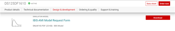

    5. Please provide the IBIS model files of DS125DF1610 and DS125MB203 chips.
    Please complete and submit the request forms that are on the product pages for each of those devices.

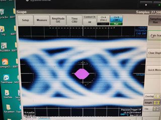

  • Above, it is the eye diagram picture. thank you for your timely reply! i'll provide register dump values for you. but now i have a confused question about "DATA RATES" for "FIRST GROUP DIVIDER" and "SECOND GROUP DIVIDER". As you know, when i set 0x2f to 0xb6, the 1G optical module links up. the value 0xb6, means "10.3125, 1.25" and  the rate for "FIRST GROUP DIVIDER" and "SECOND GROUP DIVIDER" is 8:1 . the number 8 means 10.3125G, the number 1  means 1.25G?  my question is that 8:1 and 10.3125, 1.25 is the cause of 1G linkup ,and 8:1 and 10.3125, 1.25 only is ok for  1G optical modules . Does you agree with me in this opinion? if i want to use 10G optical module, what value  i shoud to set for the "FIRST GROUP DIVIDER" and "SECOND GROUP DIVIDER"? and Could you tell me the defference of  "FIRST GROUP DIVIDER" and "SECOND GROUP DIVIDER"? and what do they means?looking forward to your reply.thank you.
    Could you clarify where this eye diagram is taken in your system?

  • the eye diagram is taken from optical module'S tx .thanK you.

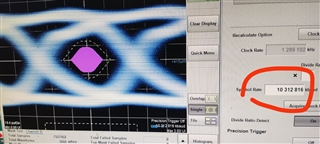

  • and i did so many experiments.now i find that the eye diagram of optical 10G module'TX is not stable ,it is geting smaller as time is going ,at last it gets stable ,just like the eye diagram i gave you before. why? why eye diagram is changing , and sometimes it doesn't look like a eye, its so fuzzy, not clear at all. looking forward to your reply.thank you.
  • a new eye diagram. the key registers 's value such as:DEM ,drv_sel_vod,FIR(pre,main,post) is as follows: DEM is 0x2, drv_sel_vod is 31, pre FIR is 0, main FIR is 0x2e,post FIR is 0x20.adapte mode addr 0x31 is 0x60 and i have a question: if i set post FIR  to be nagative int , the eye diagram is ganna be worser, if i set post FIR  to be postive int ,such as 0x20,the eye diagram is ganna be clearer.as you know, through the chip datasheet ,the post FIR should not be a postive int and should be a negative value. how to explain the situation? and above eye diagram,you look at the red circle, the clock is 10 312 816 K, but no 10 312 5xx K. from the defferent of this clock, Could you give some advices for 10G link? thank you sincerely!
    It sounds like you are applying a lot of post-cursor attenuation in order to observe a good eye.  What is the equalization of the DS125MB203 set to?  Can you provide estimated loss for the various connections in your block diagram?  This will help us better understand your system.
