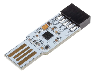

I'm trying to connect to the TPS65987 through an FTDI breakout board ref: UMFT200XD (picture below)

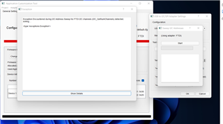

When i try to sweep address i have the error message below :
Exception Encountered during I2C Address Sweep:No FTDI I2C channels (I2C_GetNumChannels) detected, exiting....
<type 'exceptions.Exception'>
I don't understand because my FTDI device is well recognize and the driver is correctly installed
