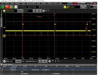

The used CCy pin will go up to ~1,6V (same as Eval board) and tries to negotiate the voltage. Shortly before the 5V supply is switched off, the voltage on CCy jumps to 4V.

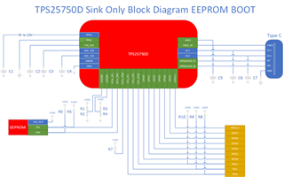

2.    Differences between my Board and the evaluation module:
  • all GPIOs are tied to GND as described in the datasheet pin description.
  • PP5V is tied to GND as described in the forum entry.
  • VIN_3V3 is not present.
  • I am using a PD only USBC socket. It only has VBUS (2x), GND (2x) and the two CC pins. No data lines available.
 there must be a differemce which I am missing but I can't seem to figure out what it is.

  5. My board: voltage on CCy pin. See attached image. I do not understand why the voltage goes up to 4V.6.    My board: I tried a different USBC power supply.--> same problem.

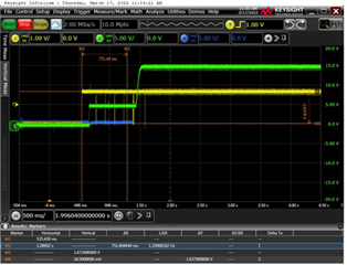

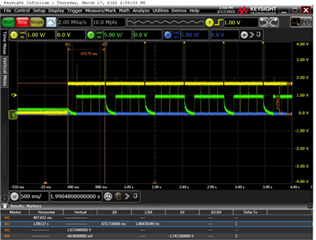

  8. compared startup on both boards (15V 3A sink only bin-File)
 (Startup Evalboard)
 (startup my board)
yellow: CCy
blue: PPHV
green: VBUS

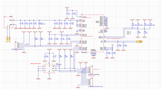

  • Juliane,
    How are the resistors on ADCIN1 and ADCIN2 configured on your board?
    The part looks like it may be going into an incorrect state.
    Based on what I see in your schematic, please remove the pull-up resistors to LDO_3V3 and LDO_1V5.  This will configure the TPS25750 into SafeMode with an I2C address of 0x21.  This will match the EVM and match your intended behavior.
    Chuck
  • Hi Chuck,
    thanks for the reply.
    The pullups on ADC1 and 2 are not populated. I placedonly the pulldowns to GND.
