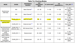

    909.792Mbps is much smaller than 3.328Gbps, so maybe can we change the CLK_IN  to 25MHz to let the cable run at 2Gbps to reduce the pressure on the cable?
  • Hi Guihui,
    You can use a 25MHz external reference clock at the UB953, which will set the Forward Channel rate to 2Gbps and the allowable input CSI-2 bandwidth to be about 1.6Gbps, as defined in Table 7-6 in the UB953 datasheet:
    Just keep in mind that there are 4 CSI-2 data lanes, which requires an input data rate between 80Mbps to 832Mbps, as defined in the datasheet:
    The reference clock sets the allowable CSI-2 input bandwidth at the UB953 receiver and the Forward Channel rate in the overall cable. You can select whichever option suits your application. I also recommend looking at Synchronous mode, since that would allow the REFCLK to be sent from the DES to the SER, and eliminate the need to add an external oscillator on the SER board.
