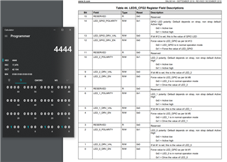

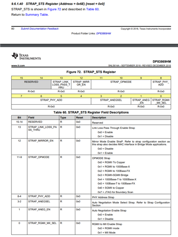

  • Hi Jay,
    1. Strap configuration can be checked in register 0x6E as seen below.
    2. strapping configuration can be changed after start-up via software in the following registers as described in the datasheet.
    dp83869hm.pdf
    Additionally, I want to highlight that LED polarity can be changed via registers as well, as per your question.
    Please let me know if there are any further questions.
    best,
    Alon

    Also 0x5E is the value in STRAP_STS(0x6E) register

    During our debug, we had all the LEDs of the PHY ON. We aimed to turn it OFF by trying different combinations of configurations by writing to LEDS_CFG2 register. We have tried writing the values 0x0000, 0x1111, 0x2222, 0x3333, 0x4444, 0x5555, 0x6666, 0x7777 to LEDS_CFG2 register, hoping at least one of the LEDs would change its state, but we observe no change.
    Following is an example of writing 0x1111 to LEDS_CFG2 register.
    root@p27_01_2022:~# devmem 0xff0e0000 32 0x00000010
    root@p27_01_2022:~# devmem 0xff0e0034 32 0x62e60000
    0x62E64000
    root@p27_01_2022:~# devmem 0xff0e0034 32 0x52e61111
    0x62E61111
    As you can see, the register originally had 0x4000 and after writing 0x1111, it reads back the value that we write. This is supposed to change the polarity to active low and turn off the LEDs. But there is no change in LED state physically. We have also tried the other values mentioned above the same way.

    0x06E: 0x005E

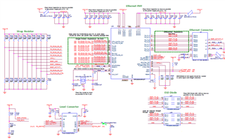

    My only question is why are you writing 0x1111 to register 0x19? I understand that you are just trying to see if anything changes but it will be better if we can write the correct values for you current application. I can find the correct register write here if you could send me your schematic.

  • Hi Alon,
    Thank you for the reply
    I've attached the schematics
    Meanwhile we are checking the driver that is being used currently
  • Hi Jay,
    Thank you for checking the Linux driver is being used correctly.
    I am not seeing LED0, 1, 2 on the schematic, are they an active high or active low LEDs?
    I just want to write the register writes out for you and need to know the correct polarity for the register write.
    Alon

  • Hi Jay,
    If you want them active high, you have to set register 0x19 (LEDS_CFG2) to 0x4444, this register should be 0x4444 by default.
    To have them all driven low, you would have to set register 0x19 to 0x0000.
    There are many settings you can play with, if you are able to get good communication from the PHY, and the LEDs are the only thing that is not working on your design, then perhaps try messing with the various LEDS_CFG registers alongside trying to make the Linux driver work with the Petalinux system you are running.
    Please let me know how you design goes and if I can help more.
    Alon
