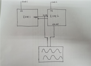

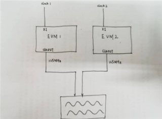

  • Hi William,
    For my test, I linked up 2 DP83867 EVMs with their input clocks from different sources with some frequency offset.
    I got the 125MHz recovered clock on CLK_OUT pin and measured the TIE of the clock output using oscilloscope.
    Gokul.
  • Hello Gokul
    Thanks for your reply!
    However, I don't quite understand what you mean, do the clocks connected to the two EVM boards come from different clock sources? As shown in Figure 1 below, are the two communicating?
    From what I understand, the two EVM boards should be connected as shown in Figure 2 below.
    Or are you setting the registers differently for the two CLKOUTs?
    I understand that the recovered clock is recovered from the RX_CLK in the network. Is my understanding wrong?
    William
  • Hi William,
    Sorry for the confusion. The first image you have shown is the setup I used for testing.
    I was talking about the inputs to XI, which are clk1 and clk2 which are from different external sources which have ppm offset.
    For now, you need not use different clocks and use the crystals for the clock sourcing.
    Gokul.

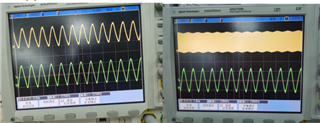

  • Hello Gokul
    Thanks for your reply.
    According to your explanation, I do not understand the following points:
    1. When you tested, did the two EVM boards not communicate through the network port?
    2. What are the reg<0x170> of the two EVM boards?
    Meanwhile, I tested according to my test scenario:
    First, I used two DP83869 boards, and the clock source used their own clock source; and got the 125MHz clock in the following way:
    0xD10 -> reg<0x170>
    0x10 -> reg<0xC6>
    Here is the solution to the previous question that you can't generate a 125MHz clock;
    Then, I connect the two boards through a network cable to realize communication, and set the reg<0x170> of board 1 and board 2 to 0x800 and 0x0 respectively;
    Finally, I run the following two tests separately through the oscilloscope:
    1. In the case of network cable connection, test the delay time of the two clocks;
    2. When the network cable is disconnected, test the delay time of the two clocks;
    The following Figures 1 and 2 are obtained;
    Based on the above test, I would like to ask you two questions:
    1. Whether test 1 can indicate the SYNCE recovery clock of the DP83869 board;
    2. In Figure 2, the two clocks cannot be stable at the same time. What is the reason? Is it because of inconsistencies in frequency?
    Is my test plan correct?
    Thank you for such a responsible reply!
    William
  • Hi William,
    From what I understand, you are measuring the delay between transmit/recovered clock or board-1 vs recovered/syncE clock of board-2.
    When the cable is connected between them and the boards are linked-up, all the frequencies are made to align and hence you see a fixed delay.
    When the cable is disconnected, the alignment of clocks of board-1 and board-2 doesn't happen. This is due frequency mismatch between both the boards. Any small frequency offset will make the clocks look asynchronous to the naked eye.
    So, overall, I think you were able to observe what is intended in your system.
    Gokul.
