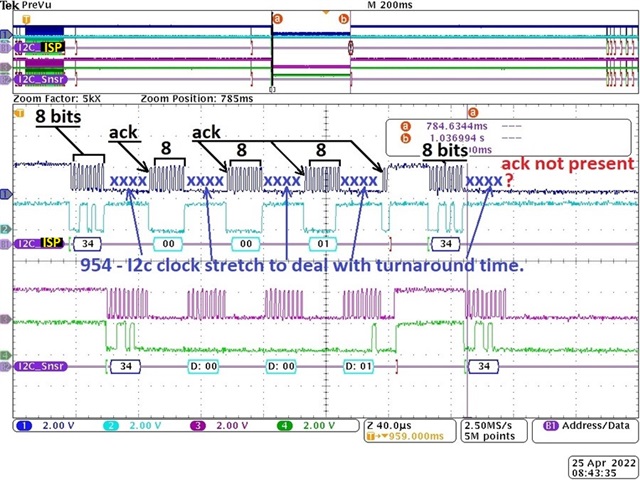

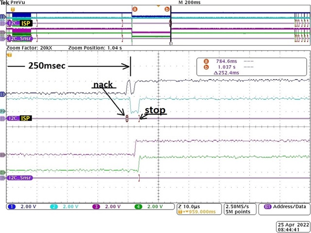

The DS90UB913A-Q1 catches ACK during I2C communication. However, ACK is not output from a DS90UB914A-Q1.
This phenomenon occurs only with a specific address, and normalcy works by I2C communicating again.
WHY?
                        NG I2C (no ack in ds90ub914a-q1)                                                            OK
CH1(YELLOW)  DS90UB913_SDA
CH2(BLUE)  DS90UB913_SCL
CH3(RED)  DS90UB914_SDA
CH4(GREEN) DS90UB914_SCL
