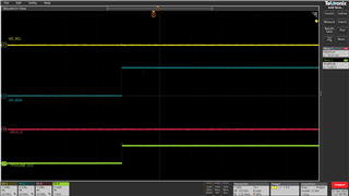

Dear experts,
We are building a TBT device and it's based on Gorilla Creek reference design. Here is our design: TPS65988DK.pdf
CN4: UFP;CN5: DFP
I tried to build an binary for our design and it seems not to work what I want.
Here is our TPS65988DK pjt setting: TPS65988DK_0407A.pjt

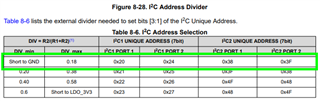

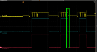

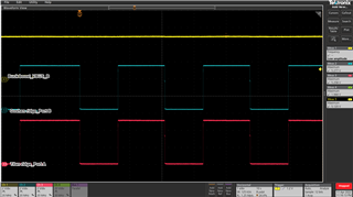

We want both Port A and Port B to source 5V/3A. But it seems to be +VBUS_A_PD sink 5V in my settings and VBUS_A doesn't have output voltage.
I2C3_SDA is keeping 3.3V high voltage and I2C3_SCL is keeping low.
I only adjust the setting in "Port Control" column.
Is there a problem with my setting?
If there is anything unclear about the description, please let me know.
