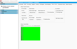

I am running the MAP tool on a 913/954 fpd link and see that all EQ and SP positions are being marked as passed. I assume this should not be the case and something is wrong as the FPD-link cable is ~5m and I would expect some positions to fail. I have attached the info page and MAP tab to see if something is wrong.

  • Hello Mathieu,
    Unfortunately, I can't see your screen shots, can you post again please?
    What is your PCLK? and used MODE?
    Also, can you repeat the MAP test with a longer cable, between 10m to 15m?

  • Here is the MAP tool screenshot
  • Hello Mathieu,
    Looking at the ALP tab it looks like this is really low frequency for the 913A/954 pair in terms of the link rate. Also the used cable is only 5m long. So it is not unexpected to get a MAP result with no errors. That basically means your system has a large margin.
    Also you are using 24MHz as a PCLK which is below our minimum specs!

  • Hi Hamzeh, I have looked into the MAP tool and it recommends disabling the image sensor when running the MAP tool. The issue I have here is that my image sensor is outputting the PCLK to the 913. So if I disable the image sensor PCLK is lost. Is there a way to make the 913 ignore the data coming from the image sensor so I can still run the MAP tool?
    Thanks, Mathieu
  • Hello Mathieu,
    unfortunately the SER can't ignore the incoming data. Hence, it is recommended to test with MAP while the SER is getting its CLK from an external oscillator MODE not using the PCLK mode
  • Thanks for the quick reply Hamzeh, so does that mean I have no way of running the MAP tool with my current design? Could I disconnect the 12 data lines with some PCB modifications and still initialise the image sensor so the Pixel Clock still travels to the 913ser but there is no data coming in? Would I also need to disconnect FPD_VSYNC and FPD_HSYNC? Cheers, Mathieu
  • Mathieu,
    You may try to disconnect the data lines as you stated with some PCB modifications, and still initialise the image sensor so the PCLK is supplied to the 913A. But I am not sure if that will success or not. No one has tested this before!
    No, you do not need the Hsync and Vsync lines.
