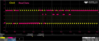

Phy Link not up and Tx Clock is having only 100mV swing in MII mode

Actually I tried reading the registers. But the read register values are going to a metastable state. Image attached.

Hi Hillman,
The pull up resistor which I used is 1.5 k ohm. Also tried with 2.4k ohm.
There is no sharing bus on mdio pin.

Hi Shafna,
Are you able to Isolate MDIO and MDC in your schematics and get a launch pad for further debug? We have the USB and MDIO user guide to tell you the instruction on how to connect them. Here is the link for the user guide:
