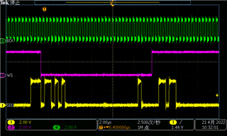

I2S: 32bit;  LRCK:48KHz; BCLK: 6.144MHz
The MCLK outputs 12.288MHz via 948
 941 register setting:
address value
0x12 0x0b
0x10 0x77
0x11 0x77
0x1a 0x00
 948 register setting:
address value
0x20 0x55
0x21 0x55
0x2b 0x01
0x3a 0xb1

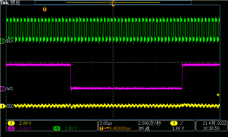

The problem that arises now is that the output is unstable I2S_SDO on the 948 side.
When the 948-side I2S waveform is OK, after restarting the system again, the waveform may appear NG phenomenon, and the I2S_SDO has no output. At NG, there is an SDO signal on the 941 side.
Based on this situation, what is your company's advice.

OK:
NG:

  • sorry,BCLK=3.072MHz

  • Hi,Logan
    I2S_DOUT transfer success is accidental,it is not necessarily possible to succeed after which system boot.
    Whether OK or not-OK, reading the return values of the registers, these register values are the values I wrote.
    Is my setpoint incorrect?
