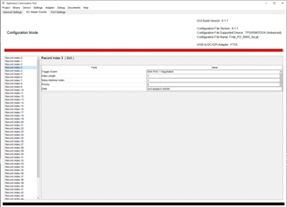

    I have the TPS65987DDHRSHR and BQ25713BRSNT together and in the case that the main controller of the system is off, the TPS should configure the BQ.
    I don't have the Slvae18 ducument in front of me but I can explain what I did.

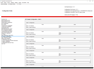

    I have set the I2C address of the slave under Port Settings - I2C Master Configuartions. (see picture 1) Then you have to activate "Show I2C Master Event Table" under Settigs. There you can set when and what should be written.
    I hope this helps you!
    Unfortunately you can only map the setting of registers to events and I don't know if you can add a delay between event and send. We have already used the product quite successfully but now and then it happens that the I2C communication does not work correctly, because probably the slave was not yet ready (I do not know it yet exactly).
    @Support: is it possible to send the I2C command more than once. So best 3 times with 1Hz.
    Best regards
    Milan
  • Milan,
    The I2C events on the TPS65988DK  will not repeat on NAK.  They are single time fire and there is no delay between the event and the fire beyond the time the code takes to execute.
    The I2C event that you have defined will write the bytes in the following order to the slave address called out at index 1
    00 00 14 c0 ad a0 41.  The ordering frequently trips up customers because it is right to left instead of left to right.
