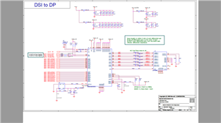

Hi TI engineers,
I have encountered one issue during using SN65DSI86. I found that the I2C bus of DSI86 was broken. The SCL is always driven to GND by DSI86 which will block I2C bus to send any command. I even can't send out command to the good devices hooked together with DSI86. Only after removing DSI86, I can send out I2C command. So in which case will the DSI86 SCL pin be short to GND?

    Can you please share your schematic and are you seeing this issue on multiple DSI86?
    The SN65DSI86 local I2C interface is enabled when EN is input high. Is EN input high?

    Actually, we don't connect multiple DSI86. But we connected other IIC devices together with DSI86. The schematic is as below. Our master IIC device is 3.3V IO level. So we used one level shifter between DSI86 and IIC master device. The level shifter is as below. Unfortunately, we accidentally reverse the connection of IIC connector ( SCL connect to GND and GND connect SCL). After that, we found SCL of DSI86 was short to GND forever.

    Can you replace the DSI86 and see if the problem is fixed? Or do you have second board with the right I2C connection and see there is an issue with the SCL?

    Yes, that is what we are going to do next. We are purchasing the DSI86 from vendor now. Do you think reverse pin connection will damage DSI86 completely?

    You may need to submit the unit for FA to see if the SCL pin is getting damaged. Can you work with our local office to submit the unit for FA?
