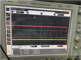

  • Hi David,
    0xF5 is 0x02, and 0xF8 is 0x01, all other registers all 0x00.
    Can you send me the entire DSI86 register programming value?
    Also, if you map the HSYNC/VSYNC to GPIO3 and use a scope to measure the GPIO3 pin, what frequency are you seeing for HSYNC and VSYNC?
    David

  • Chaodong
    Only VSYNC can be mapped through GPIO2 using register 0x5F, HSYNC can only mapped to GPIO3.
    David
  • Hi David,
    ok, i will try to map VSYNC to GPIO2, and probe that signal.
    thanks,
    best regards,
    chaodong

    I have added HSS for all blanking lines. But now we also can't make panel display. I attached the picture from the DSO I probed on DSI pins. And I am not sure about front porch lines (VFP) location. There are two data sequence from the beginning of VSS. One is sending VFP lines firstly, then VSW lines, then VBP lines and lastly VACT line. The other one is sending VSW lines firstly, then VBP lines, then VACT lines, and VFP lines lastly. Now I used the second sequence. Do you know which one should be right? Also from the DSI86 datasheet, the clock lane should align with data lane center. But from the DSO, I found that the data rising edge almost align with clock rising edge. will this cause problem? I want to check the register value of 0xf0 and 0xf1. If i write 0xff to these registers to clear them, they also will assert when corresponding error is detect, right?
    thanks and best regards,
    chaodong
  • Chaodong
    You need to make sure the data/clock does not violate the setup/hold timing as listed in the DSI86 datasheet.

  • Hi David,
    After I writing 0xff to status registers, it keeps as 0x00. How can I know it receive data without errors or just don't receive any data so it keep as 0x00?
    I am using Sync Events transmission. I only send out VSS and HSS packets. But I am not sure about when should I send out VFP blanking packets.
    As you can see from the pictures, between every frame, there is one low power period when I don't send anything. In below picture, I draw two ways to arrange packet sequence. I am not sure which one should be correct. Now I am using the first one. Do you know which one should I use?

  • Chaodong
    It needs to be VPW, VBP, and then VFP, but where is the HSS in your picture?
    There is a OMAP Panda board https://www.mouser.com/new/pandaboardorg/pandaboard/?gclid=CjwKCAiA-f78BRBbEiwATKRRBEPff5_OJSS10kk3JWzmvHHh_zXqgLXxlcltSOfmcRb9XXRcRUtrNhoClA4QAvD_BwE which we have used in the past for functional verification. But it has been discontinued and I am not really sure where you can find one.
    David
  • Hi David,
    You can see the below picture for the HSS. So the first sequence (VPW-->VBP-->VACT-->VFP-->LP) is right? Actually, I started with one VSS then one VPW blank line. Then five HSS and another five VPW blank lines. All other lines including VBP, VACT, and VFP lines were followed by HSS short packet.
    Now I mapped VSYNC to GPIO2, I can see pulse on GPIO2. But there is also nothing display on panel. The status registers 0xf0 and 0xf1 stayed as 0x00.
    Do you have any idea I can debug on?
    chaodong
  • Chaodong
    What is the frequency for the VSYNC and HSYNC? Do they match with the resolution?
    David
