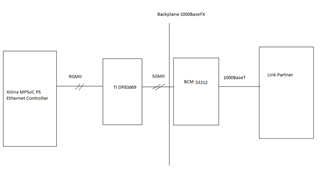

We are using DP83869 chip in RGMII-SGMII mode. Block diagram is attached for your reference. RGMII is connected to MAC of XILINX MPSoC PS and the SGMII
interface goes via backplane to the ethernet switch (BCM53312). We are not able to achieve the communication from the board to LP.
Following experiments were carried out.
1. On writing REG(0xC00) = 0x0140 the link status is detected. On trying to ping, we could observe the packets reaching at the LP (using wireshark).
On further assessing at the switch, we could see that the packets were arriving at the SW from LP but wasn't reaching the Xilinx MPSoC MAC. Are we missing anything to be configured at 1000BaseFX side?
2. We have followed the register dumps mentioned in the link https://e2e.ti.com/support/interface-group/interface/f/interface-forum/1080094/dp83869hm-dp83869-in-rgmii-sgmii-mode-does-not-work-at-100m?tisearch=e2e-sitesearch&keymatch=RGMII%2525252520to%2525252520SGMII%2525252520bridge# but couldn't achieve much.
3. We forced 1000Mbps at Xilinx-MAC, TI PHY(Both RGMII and SGMII side), BCM53312 to Copper. There's no luck.
Would you please let us know if anything else can be tried?
  • Hi Tauro,
    I want to double check if my understanding is correct for a further debug. I am not sure if my understanding is correctly and please correct me if I am wrong:
    • You are able to detect a link up only up to DP83869 board? You are able to detect a link up from link-partner up to DP83869 board right?
    • You are able to detect the packets received in SW but wasn't able to detect any packets to PS?
    • Could you read the register 006E to see rather you are in RGMII-SGMII bridge mode? I wasn't able to open the link you provided so I cannot access your register dump.
    • Did you consider the Align and Shift mode for RGMII? Please refer to register 0x32?

    Hi Hillman,
    I have attached the register dump of TI PHY for your reference.
    For your queries,
    1. We are able to detect link up from board to LP
    2. Yes, we are able to detect the packets received in SW but wasn't able to detect any packets to PS
    3. We tried Align and Shift at RGMII, result is still the same.
