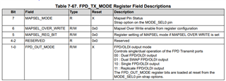

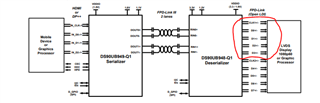

How to disable dual OLDI output and enable only single OLDi output?
which are the registers needs to be configured?

Hi Mohamed,
Bits 1 and 0 are used for setting the OLDI output mode. This can also be done using strap on ModeSel pin.
Try the following code:
write reg. 0x34 = 0x01
write reg. 0x4A = 0x02
write reg. 0x34 = 0x02
