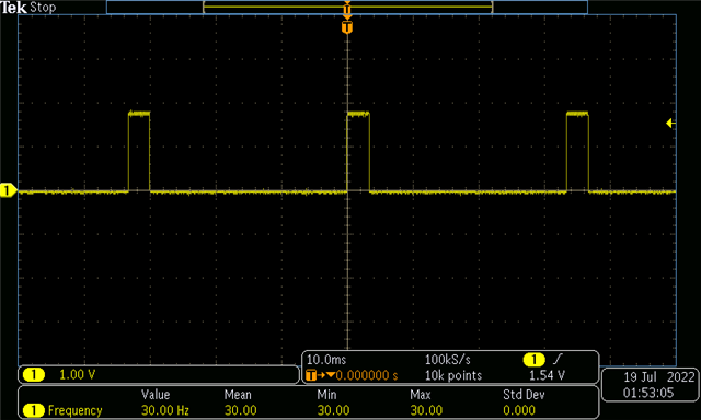

  • Hi Justin:
    Is this initialization sequence complete? The customer didn't find the relevant control of CSI and didn't know how the data came out.
    At present, the customer wants to adjust the Ti chip separately and set the ti962 chip to pattern mode. The customer refers to the example in the document. At present, I2C is connected, but Mipi has no data output
    As shown in the figure below, the pattern mode of ti962 has been running, but writing registers into 935 through 962 will report an error. The customer does not know how to debug
  • Hello Jimmy,
    Right now, it seems customer can use PATGEN, but they are still having issues communicating with the connected 935 serializer.
    The script I shared is an example of how to configure the I2C_PASS_THROUGH settings on the 962 device and allow the Host to send an I2C command over the FPD-Link devices, from Host->962->935->Camera.
    Customer would have to incorporate that into their script and change several settings to fit their actual use case. But this code is for programming registers in remote slave devices connected to I2C bus of the serializer, such as the cameras. If you just want to program the registers in the connected 935 serializers, then this should be possible if you are able to establish a stable LOCK between the 962 and 935.
    Can you perform the following checks?
    1. Can you make sure that the 935 and 962 are in compatible MODE settings?
    2. Can you verify that the 962 and the 935 have a stable LOCK?
      1. Set register 0x4C to read one of the RX Port registers and then read register 0x4D on the 962 multiple times?
      2. The LOCK_STS_CHG bit should remain 0 after multiple reads and the LOCK_STS bit should remain set to 1.
    3. The SER_ALIAS and SER_ID are automatically loaded onto the 962 deserializer after connection. Can you verify that the correct SER_ID was loaded onto the 962 deserializer in register 0x5B and that a unique SER_ALIAS_ID is set in register 0x5C?
      1. First, select one RX Port to read/write to in register 0x4C and then read registers 0x5B and 0x5C in the 962 device. If you want to write to the connected serializer, send an I2C command to the I2C address stored in register 0x5C.
    Justin Phan

  • Hello Justin:
    The PDF schematic diagram is attached. The pull-up resistance on the mode pin is removed. Now it can be locked, but it still cannot communicate through 962 and 935, and an error is reported when reading and writing registers.Why can't I write CMD into 935 through 962?
    Here is the print information:

  • We need 30Hz frame synchronization signal, which is only 28.7hz now. The following is the register configuration
    {0x4c,0x01, 0x0}, \
    {0x6e,0xaa, 0x0}, \
    {0x4c,0x12, 0x0}, \
    {0x6e,0xaa, 0x0}, \
    {0x4c,0x24, 0x0}, \
    {0x6e,0xaa, 0x0}, \
    {0x4c,0x38, 0x0}, \
    {0x6e,0xaa, 0x0}, \
    {0x10,0x91, 0x0}, \
    {0x58,0x5e, 0x0}, \
    {0x19,0x15, 0x0}, \
    {0x1a,0xb4, 0x0}, \
    {0x1b,0xc3, 0x0}, \
    {0x1c,0x50, 0x0}, \
    {0x18,0x01, 0x0}, \
  • Hello Gao,
    I tried your register settings on a 962 EVM and was able to output a 30Hz FrameSync signal from GPIO0 on the 962 EVM board.
    DES = 0x60
    SER = 0x18
    # Init config
    board.WriteI2C(DES, 0x4C, 0x01)  # RX0
    board.WriteI2C(DES, 0x6E, 0xAA)
    board.WriteI2C(DES, 0x4C, 0x12)  # RX1
    board.WriteI2C(DES, 0x4C, 0x24)  # RX2
    board.WriteI2C(DES, 0x4C, 0x38)  # RX3
    board.WriteI2C(DES, 0x10, 0x91)  # FrameSync status
    board.WriteI2C(DES, 0x58, 0x5E)
    board.WriteI2C(DES, 0x19, 0x15)  # FrameSync HIGH[15:0] = 0x15B4
    board.WriteI2C(DES, 0x1A, 0xB4)
    board.WriteI2C(DES, 0x1B, 0xC3)  # FrameSync LOW[15:0] = 0xC350
    board.WriteI2C(DES, 0x1C, 0x50)
    board.WriteI2C(DES, 0x18, 0x01)  # Enable FramSync
    # By default, the RX Port 0 BC rate is selected, 50Mbps BC = 600ns
    # Period of FrameSync = (1 sec / 30Hz) / 600ns = 55,556 counts
    # FS_HIGH_TIME = 0x15B4 = 5,556
    # FS_LOW_TIME = 50,000
    # 10% Duty Cycle
    In the code that you ran, are you certain that RX Port 0 is configured for Synchronous Mode?
    If so, then are you certain that the oscillator used on the REFCLK pin of the 962 device meets the datasheet specifications, as specified in Table 7-3 in the 962 datasheet?
    The internal FrameSync signal generated by the 962 device is directly related to the reference clock used. If the REFCLK oscillator deviates, then the internal FrameSync signal will deviate.
    Justin Phan
