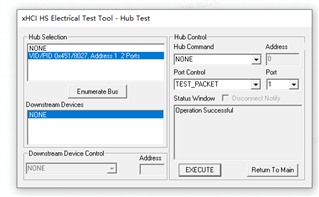

if our soc can't send test package,can we send these command by computer which run USBxHSETT tool?
we use soc connects to TUSB8020  port 0 ,one device connects to port 1, port2  connect sto a usb connector.
i think there is only one host, and it should be soc, so computer can't send these command.
is there any other way to pass eye diagram testing?
thanks
    Which SOC are you using and is the SOC on the same computer which runs USBxHSETT tool? If the SOC is on the same computer, then you should able to use the USBxHSETT tool to force the hub to generate a test packet on its downstream port using USB Test_Packet command for that specific port.

  • we use SA8155. it is a chip for auto. this picture show how we use 8020.

    You need to issue a USB Set_Feature(Port_Test) command to put the hub downstream port into test mode and have the hub itself sending out the test packet. For more detail, please refer to section 11.24.2.13 of the USB 2.0 specification.
    If you want the hub to repeat the test packet sent by the 8155, I would recommend sending a SetPortFeature(TEST_FORCE_ENABLE) and then send the test packet SET FEATURE(TEST_MODE) from the 8155, you will then able to take the eye diagram but please note that with this approach, there will be a hub tier impact on the sync bits and EOP width that may impact the eye diagram result.

  • David:
    which port we should use ?
    we tried Bus 001 Device 002: ID 0451:8027, sent TEST_FORCE_ENABLE and TEST_MODE, but couldn't get the test wave from 8155 usb 2.0 side.

  • i used the develop board and send TEST_FORCE_ENABLE and TEST_MODE, i can get the test wave from port 1.
    so this must be something wrong in 8155 side,  thank you.
