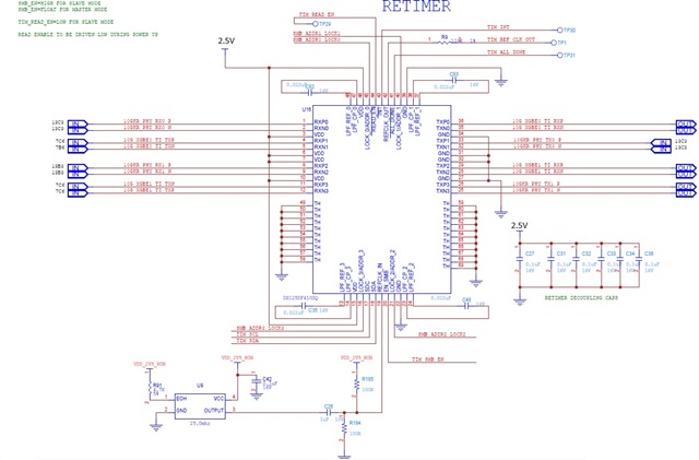

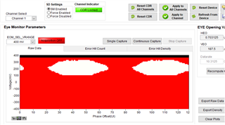

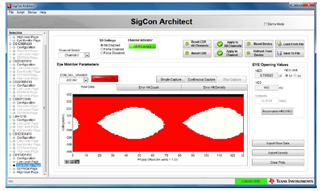

DS125DF410: TX CDR not locking
Part Number: DS125DF410
Hi TI Team,
We are using the DS125DF410 Retimer for ethernet add-in card, then connected to link partner through SFP+ cable the RX CDR is locking but TX CDR is not locking. But we did the SFI TX compliance test, and the SoC generated the PRBS 9 and PRBS 31 pattern and send it through retimed output and captured the good eye. Let's share your feedback if we are missing any settings.

  • Hi Rodrigo Natal,
    We are working with internal SI team for channel insertion loss and s-parameter, and will share the report once received.
    PFA the retimer CDR lock status and eye details for your reference.

  • Thanks for the update. My one major comment is that your retimer input eye opening monitor (EOM) 2D plots look very unusual. I would expect for normal cases that EOM plots would look like the example plot below. In the plot below you have a CML differential signal that swings from -400 to +400 and centered at DC value of 0.
    Your plots do not look like this. Thee look real bizarre. I would speculate there are provblems with the input signal to the retimer on your system board.

  • Hi Rodrigo,
    We enabled the CH2 & CH3 and configured recommended settings, then tested CDR was not locking.
    PFA the SCH block diagram, Platform we have mux with cap on RX path then connected to PCIe connector. Add in card, between mux and retimer, default 0 ohms on TX path and 220nF on RX path. After replacing 0 ohms into 220nF on the TX path, the CDR is locking and good eye.
    Is there any recommendation for the capacitor to be placed close to the retimer?
    BD_AIC1.pptx
    Sathish.
  • * Platform we have mux with cap on TX path then connected to PCIe connector.

  • As per the datasheet this retimer needs AC coupling caps to be implemented externally for both high-speed inputs and outputs. AC coupling capacitors in the
    range of 100 to 220 nF are adequate.
