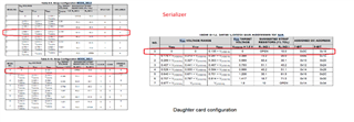

we are using ub941 serialiser and ub948 deserialiser, connections are made as shown above,
we are using single MIPI DSI and dual FPD link and single OLDI output.
could you please send the register configuration sequence that we need to do in serialiser as per the above mode and configuartion.
and the registers that we need to modify in deserialiser for single oldi.

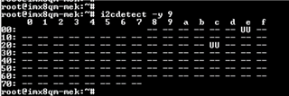

i2cdetect:
Serialiser config:
Deserialiser config:

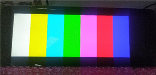

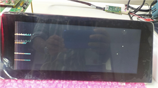

internal pattern generation is working properly,
could you please revert back on the register configuration of serialiser and deserialiser and the possible issues we are facing.

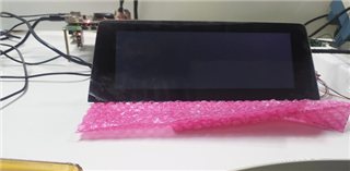

Backlight is turned on and we are getting black screen,

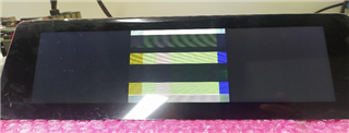

for clock frequncy 207Mhz(frequencies in the range 200Mhz-217Mh also), we are getting something as shown in below images. after doing a DSI reset using i2c commands given below.
i2cset -y -f 9 0x0e 0x01 0x08
i2cset -y -f 9 0x0e 0x01 0x00
Then after running modetest command, we are getting images as shown below.
Thanks&Regards,
Musthafa av
    For the internal pattern generation, is this the 941 or the 948 patgen?

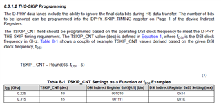

    When you provided the screenshots showing the displays with artifacts, you mention that a clock frequency of 207Mhz is used. The datasheet for the UB948 states that it supports 192Mhz max for dual channel.
    Could you provide the main page registers for the UB948 and the UB941? Could you also provide the DSI indirect registers for the UB941?
    Because DSI can be tricky to deal with at times, I will link an app note specific to the 941 for your reference.

    1. pattern gen for 941
    2.following are the i2cdumps of serialiser(0x0e) and deserialiser(0x2c) respectively.

  • Hi jack,

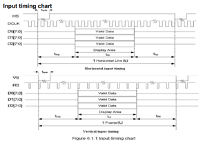

    1. UB949 is able to get timing parameters right for the display (which require TCON to be configured) for the data coming from HDMI source.
    2. Whereas with UB941 we are only able to generate test patterns successfully for that display but not the data coming from MIPI
    We believe UB949 serializer is similar to UB941 apart from supporting HDMI instead of MIPI. In that case can we get configurations to get MIPI data to be
    coming on the display without any TCON configurations (for now we arent having the support to configure TCON in our design hence wanted to utilize the test pattern generation method to get our mipi data in the display)
    Below is the list of i2c registers we are writing to generate test pattern from UB941 serializer to the display

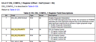

    # Set Sync Polarities
    i2cset -y -f 9 0x0e 0x66 0x0E # enable PBSC Register
    i2cset -y -f 9 0x0e 0x67 0x03 # to set desired horizontal and vertical sync widths to "Negative"

  • Hi Musthafa,
    Thank you for the provided information. If the 941 PATGEN is able to display properly, this isolates the issue to the MIPI side.
    Could you confirm the following?
    1. Is the current PATGEN using internal timing and internal PCLK?
    2. If so, enable DSI source and enable 941 DSI receiver. Enable 941 PATGEN with internal timing and external clock
    3. If step 2 displays without any artifacts, enable PATGEN with external timing and external clock.
    4. If step 3 works, disable PATGEN to see if video is OK.
    Let me know what step the video begins to encounter issues. This will help identify the issues with the DSI setup.
    Jack

    i2cset -y -f 9 0x0e 0x65 0x05 # enable Auto-Scrolling with internal timing
    i2cset -y -f 9 0x0e 0x64 0x11 # enable the pattern generator
    i2cset -y -f 9 0x0e 0x01 0x00 # REG:RESET_CTL --> Enable DSI

    Our TFT display is not using DE signal. it uses negative HS signal and negative VS signal.
    could you please let me know which are the registers needs to be set in serialiser and deserialiser along with vlaues.
    here i am attaching the input timing chart of TFT display.
    Both HS and VS are negative.

  • Hi Musthafa,
    For the UB941, the DSI_CONFIG_1 register has fields for VS and HS polarity.
    # HS, VS negative polarity configuration
    i2cset -y -f 9 0x0e 0x40 0x04 # select DSI/D-PHY Port 0 Indirect Registers
    i2cset -y -f 9 0x0e 0x41 0x21 # select DSI_CONFIG_1 Register
    i2cset -y -f 9 0x0e 0x42 0x60 # set VS and HS polarity active low
    Only the UB941 registers need to be configured for HS and VS negative polarity.

    I have faced issue in Step 3
    i2cset -y -f 9 0x0e 0x65 0x09 # enable Auto-Scrolling with external timing, external clk
    upto step2 pattern was generating

  • root@imx8qm-mek:~#
    root@imx8qm-mek:~# i2cset -f -y 9 0x0e 0x40 0x04
    root@imx8qm-mek:~# i2cset -f -y 9 0x0e 0x41 0x2A
    root@imx8qm-mek:~# i2cget -f -y 9 0x0e 0x42
    0x3e
    root@imx8qm-mek:~#
    root@imx8qm-mek:~#
    regards,
    Musthafa
  • Hi Musthafa,
    The reported value is as expected. Do you know the DSI clock frequency? Could you also report back the value in the DPHY_SKIP_TIMING register (offset 0x5)?
    Jack
  • 0x40 0x04 0x41 0x05 0x42 0x0E
    DPHY_SKIP_TIMING  is already set in device tree reg_config. please check on the device tree added in the initial stages of this thread.
    we tried with different pixel clock frequencies. (60Mhz-207Mz), refer the previous threads
    dsi frequency i calculate based on the below equation.
    Fpclk= (Fdsi * No.of dsi lanes)/12
    we are using a 4 line dsi.
    regards,
    Musthafa
  • 1920x720_Display Bringup.docx
    here i am attaching the document that i have prepared so far
  • Hi Musthafa,
    The DPHY_SKIP_TIMING register must be adjusted when the Fdsi/Fpclk is changed.
    In the device tree, you used a clock frequency of 75193600 Hz. This clock frequency computes to a DSI frequency of 225 MHz. With this clock frequency, the DPHY_SKIP_TIMING register should be 0x14.
    Jack
