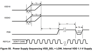

    Can you probe the power supply pins on the 954 at room temperature and then at the high temperature (70'C ambient) and check to see if the Power-Up Sequence defined in the 954 datasheet was followed in both scenarios?
    See Figure 55 and Figure 56 in the 954 datasheet and see if you can replicate the relevant figure on an oscilloscope.
    In extreme temperature conditions, additional voltage ripples may be added onto the power supply, which would affect the stability of the voltage applied at the power supply pins of the 954 device. You mentioned that the 953/954 do LOCK at normal temperature, but later lose connection when ramping up the temperature. This seems to me that the Power-Up Sequence was followed at room temperature, but as the temperature rose, the voltage ripple on the power supply pins exceeded the limit of 1.8V(+/-5%) and 1.1V(+/-5%).
    If excessive voltage ripple is present at 70'C ambient, then if you try to power-up the 954 device at 70'C the Power-Up Sequence might not have been followed and the 954 will act in an erratic behavior.

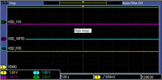

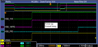

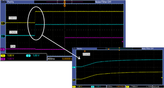

  • Hi Justin,
    I am doing all the measurements with an oscilloscope.
    The following image shows the power-up sequence. It is not altered by temperature.

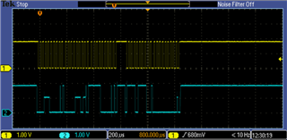

    Also, we measure the I2C signal that is altered when there is a temperature increase. I show a photo below.

  • Hello Adrian,
    Thank you for the screenshots and the additional clarification on the issue in your system.
