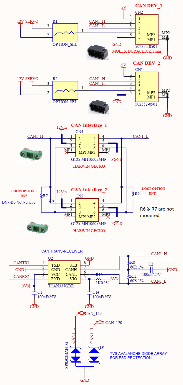

I am using TCAN337 to connect upto 7 CAN nodes in a network for automotive application. I have dual CAN configuration, where CAN1 has 5 nodes and CAN 2 has 4 nodes. The circuit includes split termination (two 60 Ohms along with 0.1uF capacitor to ground) on one end (inside PCB) and standard termination with 120 Ohm physical resistor at connector of the last node. We also have SP0502 TVS protection diodes (rated at 5.5V and clamping at 8.5V) between CANH to ground and CANL to ground for each nodes (PCBs).

  • Dear Chris,
    Thanks for your reply. I am attaching the CAN section of our CAN Boards.
    There are several such boards and each board serves as one CAN node.
    Each card has two CAN connectors (CN4 & CN5) out of which one is for input CAN connector and second is for output CAN connection.
    Each connector for CAN has got 6 wires - One for 12V supply, One for Ground, One of CANH, One for CANL, One for CANH-LOOPBACK and one for CANL-LOOPBACK. The CAN connection running into this board enters through CANH and CANL. Then it is looped back to the next CAN board using a CANH-LOOPBACK and CANL-LOOPBACK. This way we can daisy-chain all the nodes in our CAN network. The last board does not use the LOOPBACK connection but instead uses a 120Ohms termination resistor. The resistors R8 and R11 are not mounted on CAN boards except for the first controller board which has a microcontroller controlling the entire system operations. There is a shield above these 6 wires, but the shield is left unterminated on both ends. Also this bunch of 6 wires run close to 48V live and return wires running from battery to the motors. The connectors CN1 and CN2 are mounted on boards and are for debugging purposes only and do not have any harness in actual operation.
    Kindly let me know if you need further details. Thank you for your support and valuable guidance.

    Have you double checked to the wiring and connectors to make sure that they are connected correctly. You might be shorting the 12 V rail to GND on the device that burned.
    I would start off by checking all your psychical connections. Also can you send me a picture of the device that got burned? If possible are you able to tell which pin got damaged?
    My only question about the schematic is the VIO pin. The TCAN337 does not have a VIO pin. Pin 5 is a FAULT pin. Can you confirm which device you are using?
    Chris

    All boards share the same PCB design. Also I checked if there is any component on bottom side of transreceiver but there is nothing exactly below CANH & CANL lines. There is a partial area cover by the connector on the top side which has a 12V net (NETCN2_4). (See figure)
    Yes we replaced the CAN transreceiver and TVS diode in cards with Burnt IC as well as Faulty IC. We found that the cards which had faulty ICs are now up and working fine. But the cards which had burnt IC have now normal currents, but the CAN node still can't be detected after IC replacement. We probed the CANH/CANL lines to see the behaviour and found that in absence of any CAN node the CANH and CANL waveforms of the Card (having the burnt IC replaced with a new one) are OK (complimentary data patterns visible on scope), but the moment we connect it to another good CAN node, the CANH/CANL waveforms are no longer normal (infact we see same polarity swings in CANH and CANL). Still trying to understand this behaviour.

    Thank you for your support. Your recommendations were pointing out to a overstress occurring in the system. But it took us some time to locate the source of the overstress. After several investigations, we found that in our system we were using a loopback connector. Occasionally we were using a temporary loopback connector which was not properly soldered/sleeved and so we suspect that due to this connector there might be a temporary shorting between CANH and 12V supply since the pins were adjacent in our connector. We tried to simulate the failure on some cards by shorting CANH to 12V and we found that in presence of TVS diode, the TVS diode first fails in short mode and after that becomes open. In such cases the TCACN337 fails but does not burn out. However if the TVS diode is absent and if there is a shorting then it leads to burn out of TCAN IC similar to what we had seen.
    The exact failure mechanism is still not clearly understood, but our hypothesis is that most likely there was a shorting between CANH and 12V. If shorting is momentary then only TVS diode fails (first in short mode and then in open mode), but if it is sustained then TCAN also fails. In case of TVS diode becoming open due to momentary shorting, any further fresh shorting, leads to a burn-out of TCAN. Please share your thoughts about it.
