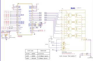

- they used LPJG16314A4NL RJ45 connector, same as TDA4VM EVM.
- when they connect RJ45 connect which is same as EVM, link does not active.
- when they connect 4pin->6pin/5pin->4pin/6pin->5pin of RJ45 connector, link is active and ping test is normal, but transmitted video data is broken.
Could you guide me about the possibilities of this error? and it would be very helpful if you teach me something to fix (schematic, layout, software, anything.)

    Also, this transformer does not look like what we have recommended in our datasheet. It appears that center taps are shorted on PHY side which violates datasheet.

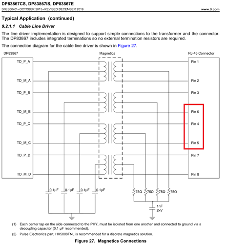

    1. They connected 4/5/6pin across each other because they saw typical application in the datasheet. as you can see, the sequence is little different.

    4. As I said, my customer used the same RJ45 connector which is used in TDA4VM EVM.
    what is your suggestion for transformer and RJ45 connector? and please let me know clearly about the connection of RJ45 communication line.
    (cross connection of 4/5/6 pin or not)
    5. Is not it necessary to supply any voltage to pin2 of RJ45 connector?
    6. I attach a layout of customer's PCB for your convenience.

  • Hi Chase,
    I am still not understanding what you mean by 4/5/6pin across each other. Would you be able to draw a diagram between 2 RJ-45 pinouts so I can better understand the setup?
    Sincerely,
    Gerome
  • Dear Gerome,
    Hope you had a good weekend.
    Here is simplified diagram for you.
    # Case 1 (pin 4,5,6 is directly connected to TD_M_B, TD_P_C, TD_M_C each without transformer.)
    # Case 2 (pin 4,5,6 is directly connected to TD_M_B, TD_P_C, TD_M_C each with transformer.)
    # Case 3 (pin 4,5,6 is directly connected to TD_P_C, TD_M_C, TD_M_B each with transformer -> It only works to 100Mbps.)
    1. I already confirmed that the schematic of my customer and TDA4VM EVM is the same. (just like Case3)

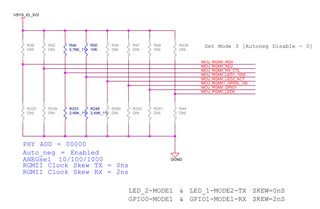

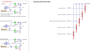

    2. I saw about strap configuration from 37 page of the datasheet and so on TDA4VM EVM's schematic. Is it necessary?

    With any configuration of our PHY, we require the MDI configuration dictated in our datasheet. Any configuration that deviates from this, whether it be lack of transformers, different style wiring, etc. puts validation responsibility solely on customer.
    I am still unsure what is the purpose of pointing out pins 4-6 on RJ-45. Where is all the other pins?

    2. I saw that the strap configuration of TDA4VM EVM and DP83867IS EVM are different.
    (Left is in TDA4VM EVM, right is in DP83867IS EVM.)
    which one is prefer for standard operation? and should we change register settings if we use different strap configurations?
    Chase
  • Hi Chase,
    With register dump, I can make some sense of it, but I am not clear on what the setup is with the RJ-45 still. What are the other pins connected to? Since customer is trying to accomplish 1G communication, all pins are needed.
    Both sides have independent configuration that is for their own use cases. It appears that the DP83867ERGZ-R-EVM does need RX_CTRL strapped to Mode 3 or 4 (looks to be using default). The only differences between the EVMs are RX_CTRL and LED_1 (TDA4 in mode 2, 867 EVM is mode 1. Both are valid configurations). Configurations are all dependent on your customer's use case.
