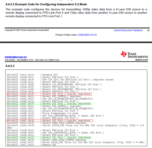

Dear expert,
To write something to indirect register, 0x40 bit 0 should be 0. But below code in red and green doesn't follow this rule. Is this mistake?
